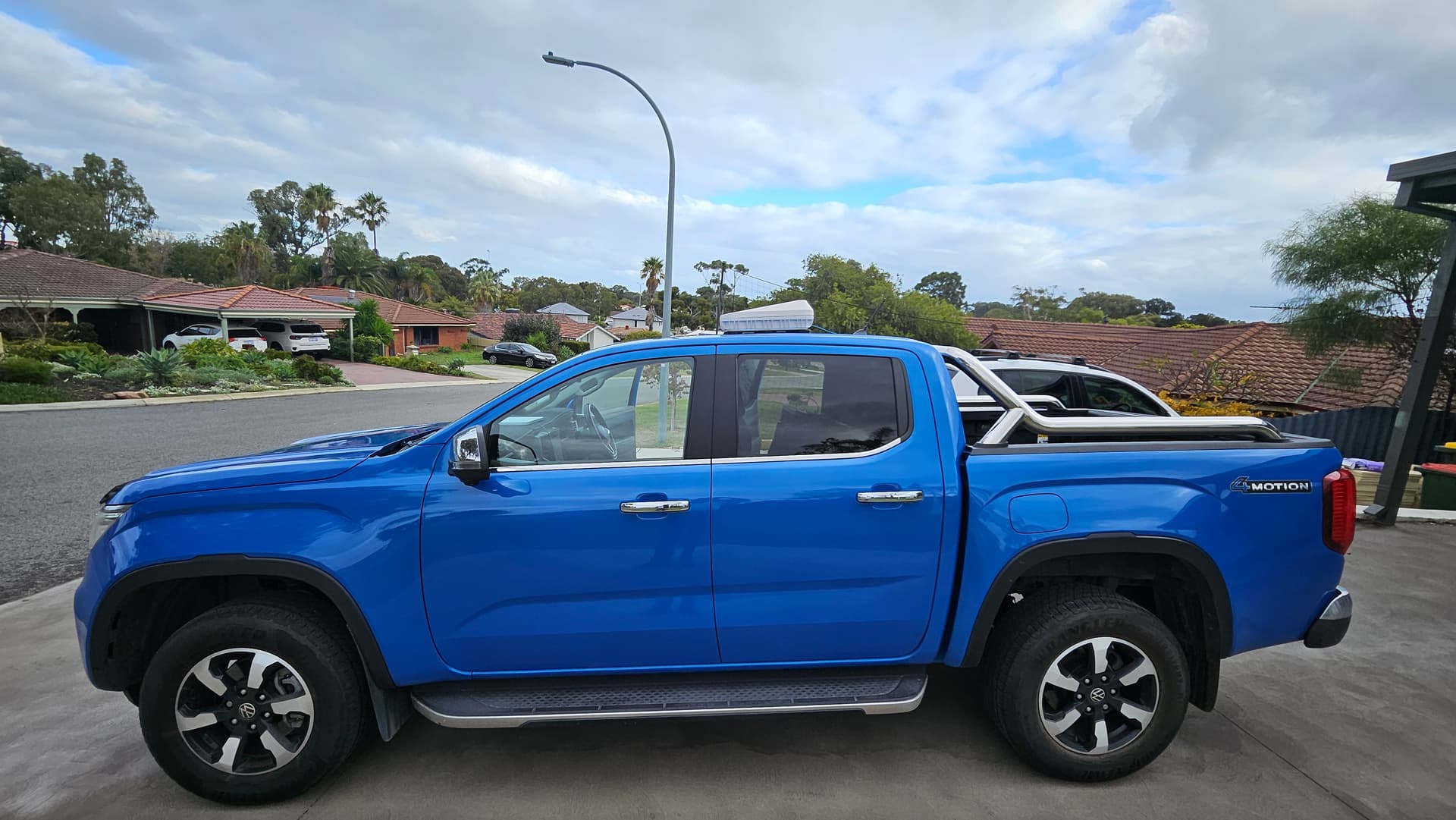

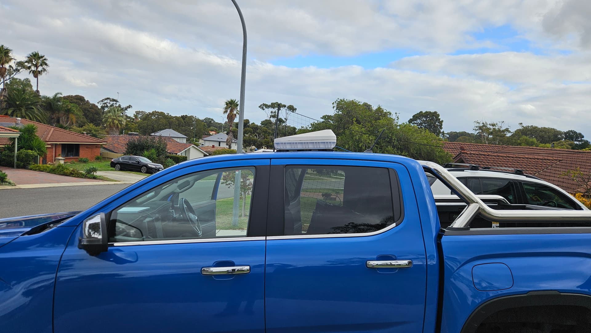

Thought I would add some real world use case here. I am using (borrowed from @mldowling) Antenna Max S on my vehicle. Has onboard PoE splitter to drive the Peplink and SL Mini.
In the vehicle I’m running a Tycon 802.3 BT switch so power& data to antenna Max S assembly is via a single ethernet cable…
Tablets and other wifi based stuff easily integrates into this and the switch in the vehicle allows Ethernet connectivity.
The switch allows me to plug in various other tech… Eg. I integrate a DJI Enterprise drone (with a VideoSoft Gateway) into this network and relay drone footage eg SAR ops… back to a hub router instance/NOC.
I don’t specifically use SFC itself as I host a hub device over Starlink +Telco…
The switch also powers industrial mesh nodes so I can extend the network connectivity and scale it very quickly to allow connectivity far beyond the typical wifi ranges.
The system design is totally portable and self sustaining… There’s a 100AH LifePo4 battery bank powering the entire assembly to ensure I don’t flatten a vehicle battery which charges off vehicle power whilst I’m running. Everything is quickly dismounted so I don’t wipe off the roof mounted stuff as I enter a Perth Carpark or a MacDonalds drive through.
That being said I’d like to see a more rugged antenna max S… I don’t see that clip on cover surviving the corrugations on the Gibb River Road that eats caravan shock absorbers and wheel nuts for breakfast.
Images below show mag mounted Antenna Max S but I run coated steel cable tethers to the roll bar. Newton’s Third Law of Motion doesn’t give 2 hoots about ABS…
