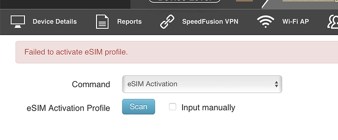

Hello,
E-sim is failing to activate
There is no logging or reason of the failure
Carrier: Vodafone NL
Country: Netherlands
QR & Manual input of the ICCID is failing
Hardware: MAX BR1 Pro 5G
Firmware version: 8.4.0 build 5396

Same issue on my side as well. Even if I input the code manually. Do you have any updates regarding this?
Alex,
What is returned on the device event log?
Dear Emil,
Please find below.
Oct 27 15:25:43 WAN: Cellular 2 SpeedFusion Connect 5G/LTE disabled, switching to SIM A
Oct 27 15:25:38 WAN: Cellular 2 BYO eSIM download failed (Download profile parameter error)
Oct 27 15:25:38 WAN: Cellular 2 start BYO eSIM download
Oct 27 15:24:58 WAN: Cellular 2 switching to eSIM slot
Oct 27 15:24:54 WAN: Cellular 2 preparing for BYO eSIM download

Hello,
could this be solved?
I have a similar problem with O2 Germany.
After manual input I get the following message:
Failed to activate eSIM profile. Server communication issue
On cellular eSIM seems to be activated:
Peplink eSIM IMSI: 4XXXXXXXXXXX14 (In Use)
ICCID: 8XXXXXXXXXXXXX31
EventLog says:
2024-02-20 08:10:58 WAN Cellular start BYO eSIM download
2024-02-20 08:11:29 WAN Cellular BYO eSIM download failed (Server communication issue)
Any ideas?
