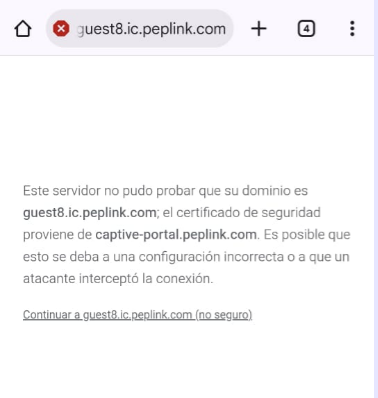

We deployed a Custom Captive Portal across several platforms and are now facing the “expired Certificate” problem.

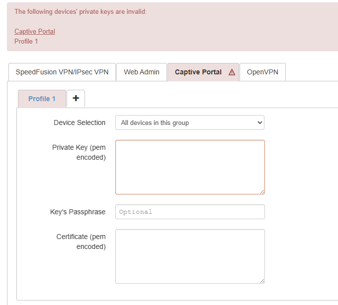

Now, as we already created a wildcard letsencrypt certificate for other manufacturers’ routers we employ or support I tried to leverage on InControl 2 Group Wide Certificate Manager to upload the same certbot generated privkey.pem and fullchain.pem in the relative fields but obtained an error.
Tried with all of the other files’ combination from letsencrypt’s folder with always the same error.
Same with a different non wildcard certificate.
When uploading the certificate directly through the device web admin the couple privkey+fullchain worked like a charm.
But I’m scared just thinking about uploading these certificates every two months and a half on each router when doing it in an interface like InControl2 would easily avoid me what Germans call Weltschmerz.

  • Is it a bug in InControl2? Otherwise why is everything working on-device but not through InControl2.

Hi, I had a similar case with Peplink, but devices do have Essential/PrimeCare. Problem was in certain versions of the Peplink firmware, captive portals, and having network groups enabled, it was throwing a certificate error.
In my case, they released a special version, and that resolved the problems.
Are you using grouped networks ?
