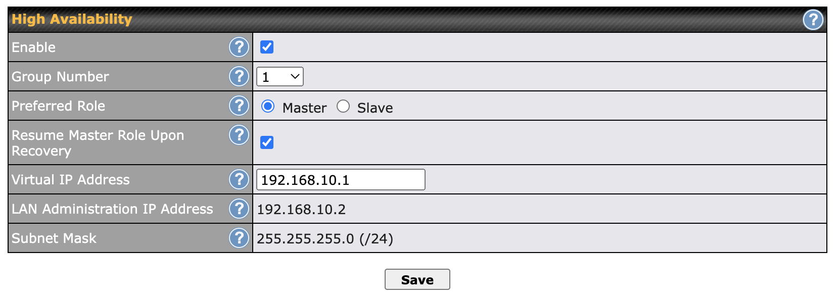

@JasonHilton, may I know how you conducted the failover testing?
As I have tested with our devices (Balance 305, FW8.2.1), when the Master unit LAN interface is disconnected, it will switch to Slave mode in 3 seconds, as per the user manual stated.

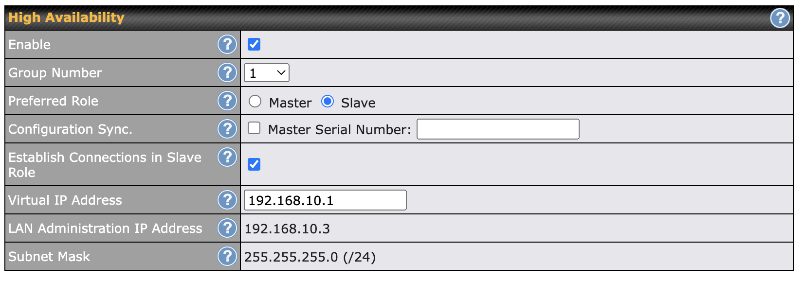

Do take note that when the Slave unit take over as Master, the WAN interface will initialize/negotiate the connection, before client traffic can be forwarded. Maybe you can consider this option (highlighted) to help shorten the downtime.
@WeiMing Thanks for the quick reply!
I have that enabled as well.
For testing, I had a ping to google.com running. When disconnecting the master, there were 9 failed pings before the slave took over.
I am following the similar setup in my lab test:
When I have Config Sync. with the Master (w/o the “Establish Connections in Slave Role”), I have about 5 PING timeout to 8.8.8.8 during the HA failover (disconnect LAN).
If I enabled the “Establish Connections in Slave Role”, I get average 2-3 PING timeout to 8.8.8.8 during the HA failover.
