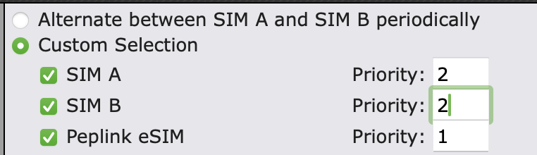

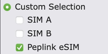

  1. when arriving at the campsite, I had zero signal. I waited perhaps 20 minutes and nothing worked. This BR1 mini has 2 sim slots, but zero physical SIMs installed; however the eSIM was listed as priority 1.
It seemed like the BR1 was stuck, and was not using the eSIM

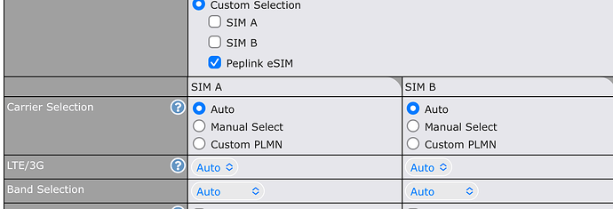

The solution: I manually disabled SIM A and SIM B. After saving changes, the eSIM quickly connected. Is there a bug with eSIM priority?
This did not work:

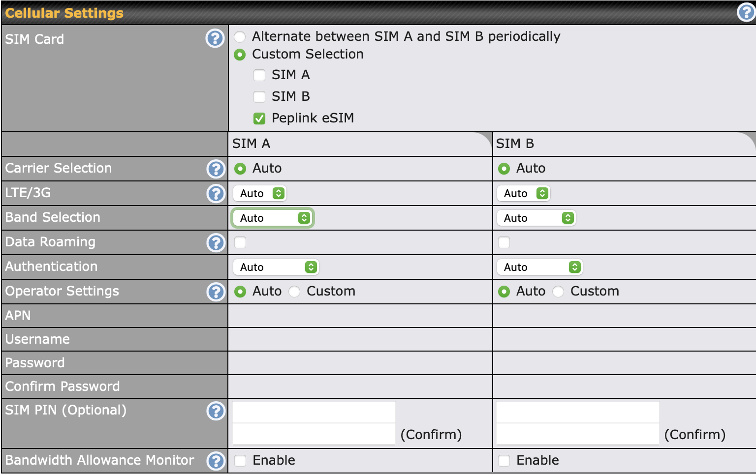

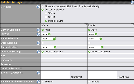

  1. I can’t see any way to manually select options for which band(s) or carrier(s) the eSIM is supposed to use. The UI i’m seeing shows these options, but only for the physical SIM cards A and B:
Where do I access the UI to change the eSIM settings?

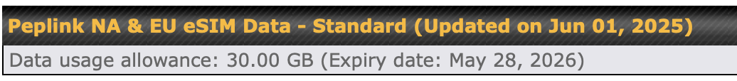

  1. There’s no easy way to see the data used. The dashboard shows my eSIM total quantity, but not usage. It would be nice if this was displayed on the Dashboard:

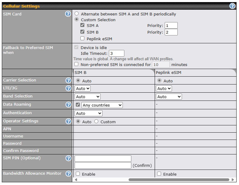

Where it says carrier selection click on the ?, Peplink hides many of their advanced menus behind those blue question marks.
When I do that, I do see options for SIM A and B, but no options for the eSIM. This is my confusion.

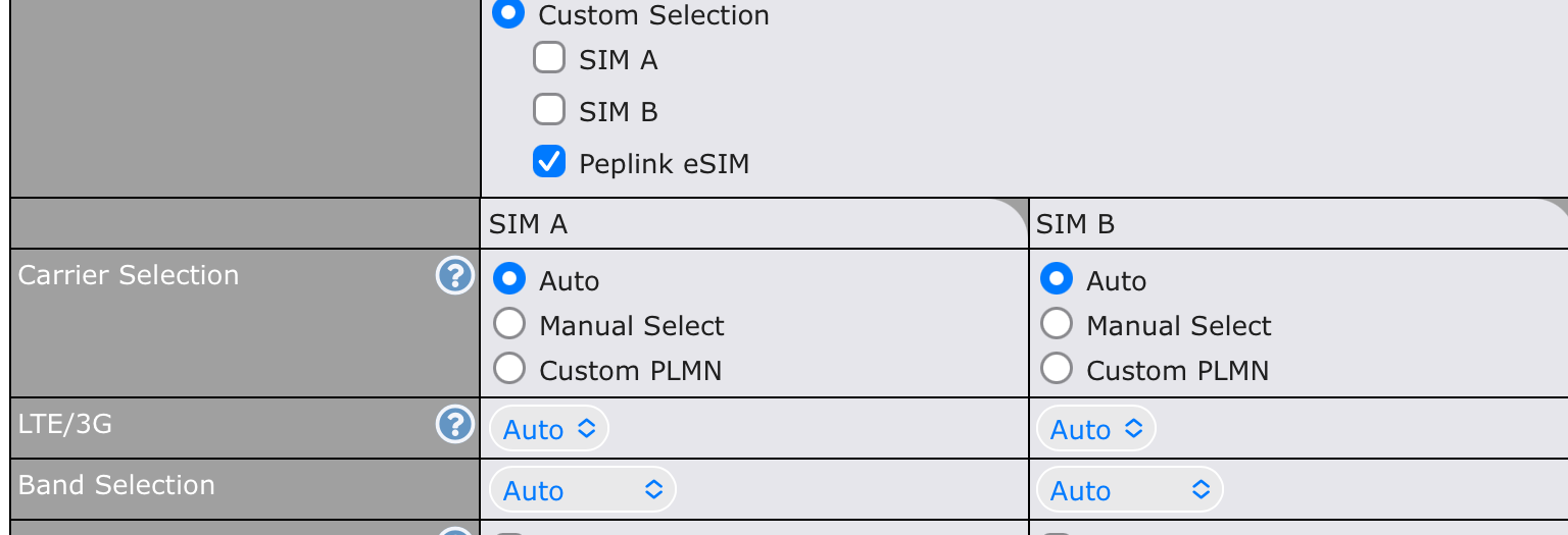

It should be there, see this for example:
Maybe try another browser?
Ahoy there!
Don’t forget to scroll to the side (from left to right):
@Captain_Nik has it - I was accessing this using Safari browser on my iPad. I just tried it again and indeed you can scroll to the right. However, by default on my iPad, the UI shows up with almost precisely the right # of pixels for SIM A and B to show up, so there’s basically no indication whatsoever that other SIMs are hidden to the right.

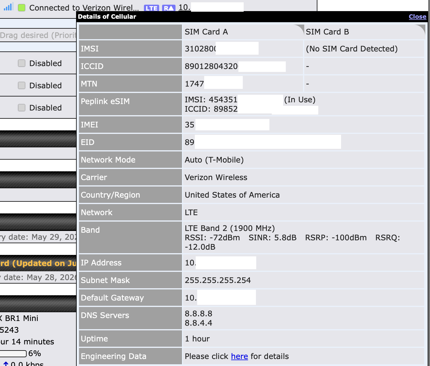

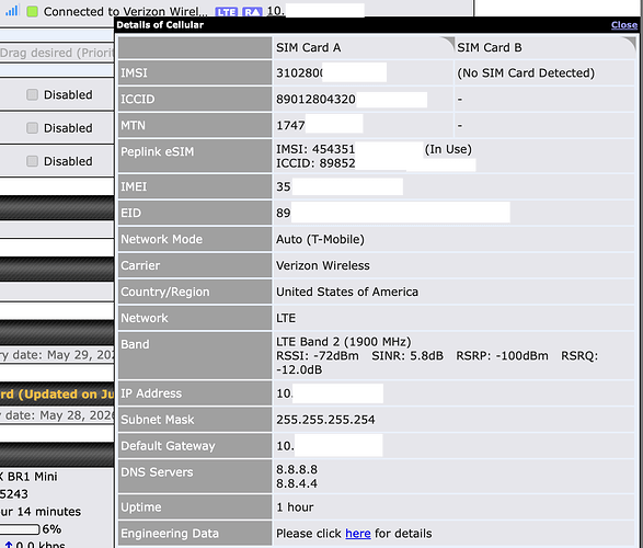

When clicking the IP address on the Dashboard, there is a different UI popup which looks like this:
In this UI I am not able to scroll to the right - but I think all the eSIM details are being shown. Or should I also be able to scroll to the right in this UI and see a 3rd column for eSIM? It’s confusing.
