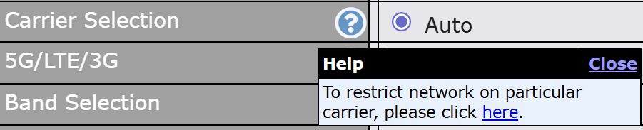

Click the question mark next to carrier selection and click the blue here

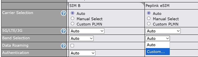

Next use the scroll bar at the bottom of this dialog to go right till you can see the ESIM card instead of just SIM A and SIM B and select Manual Select
A box will open, select Scan, wait for results and select what you want, hit OK, then Save and Apply. Might also have to apply changes globally too, not sure.

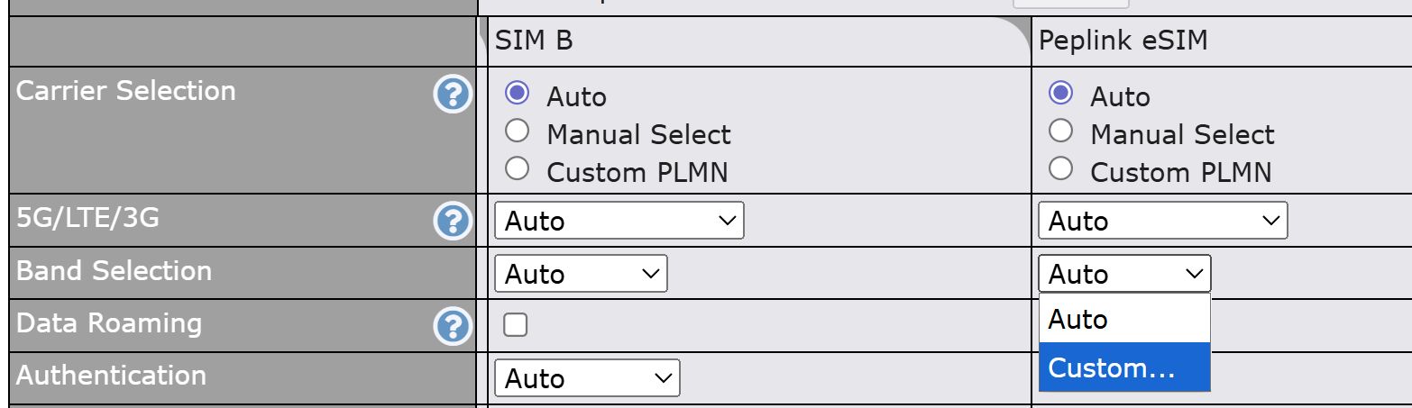

2: ALTERNAT WAY, only try this is the above fails
If the carriers in your area use different bands, you can instead select the bands for just the carrier you want it to default to, it’s in basically the same spot, just a few lines lower
As soon as you click custom, it will fill an entire list of all the bands that your modem can do, uncheck everything except what you want it to connect to then Save and apply the changes.
