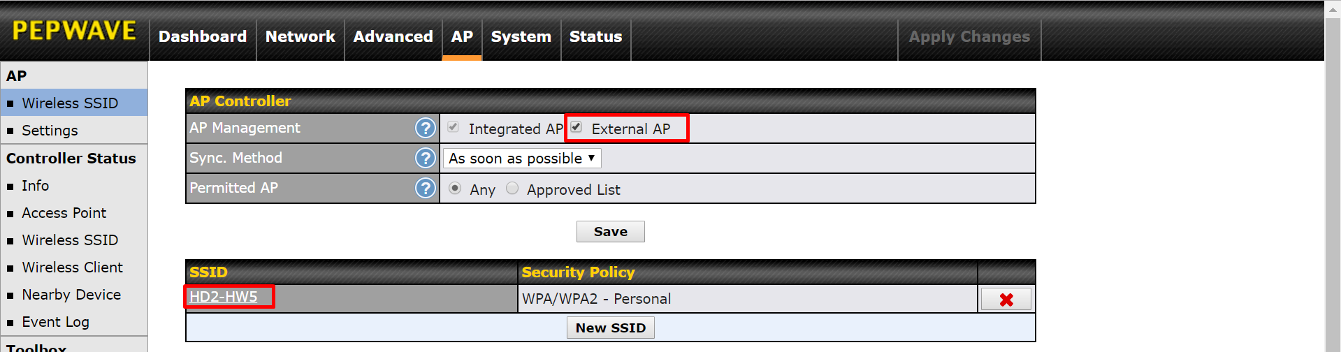

- Checked “Integrated AP” on the HD2 under AP Controller
- Created a SSID under the HD2 AP Controller

If I go on the HD2 under AP and click Access Point, it only shows the HD2 built in access point even if I check “Include Offline APs.”
