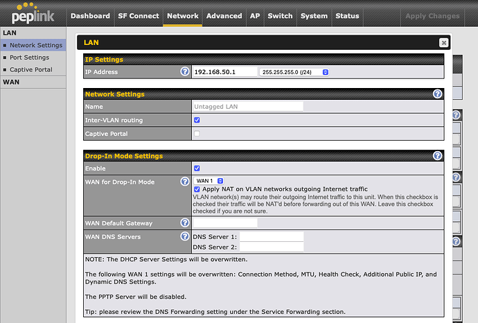

  1. Screenshot 1: LAN settings before Drop-In is touched — normal IP address (192.168.50.1/24), Inter-VLAN routing on.

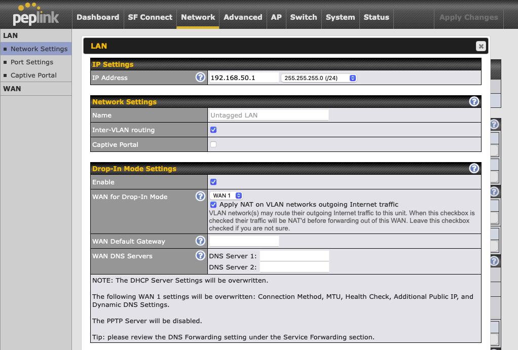

  1. Screenshot 2: Enable Drop-In Mode, pick the WAN carrying your Starlink connection, and leave “Apply NAT on VLAN networks outgoing Internet traffic” checked unless you have a specific reason not to.

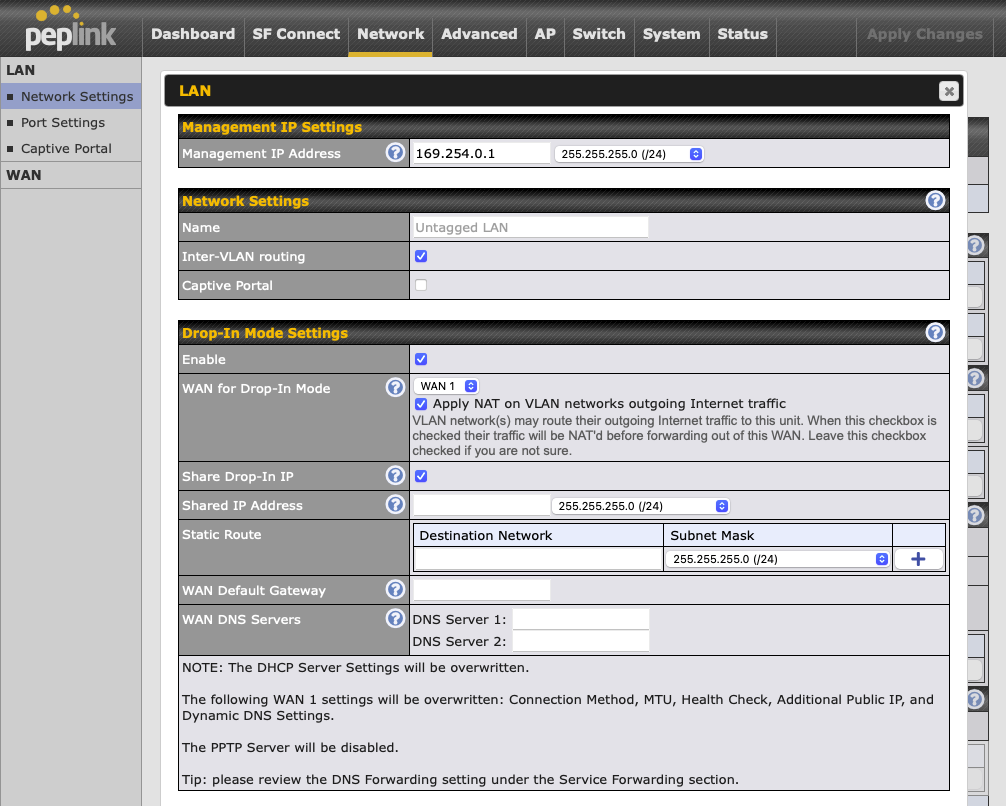

  1. Screenshot 3: This is the important one —
  • Management IP Address: 169.254.0.1/24 (see above for why)
  • Share Drop-In IP: checked
  • Shared IP Address: your single Starlink public IP
  • WAN Default Gateway: your Starlink WAN’s gateway IP
  • Static Route: only needed if something behind your downstream router needs the Peplink to know how to reach it — leave blank otherwise
