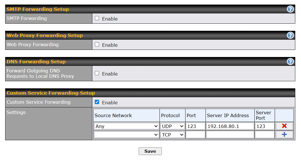

I’ve enabled NTP service forwarding on my BR1 Pro 5G (rev 3):

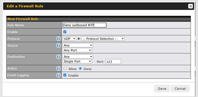

🟡 Practical Reality on BR1:
You can’t transparently redirect NTP traffic with service forwarding.
Why?
BR1 does not have a NAT redirection engine for arbitrary UDP services
Service Forwarding on that model is non-transparent
Your firewall rule blocks traffic before any forwarding rule applies

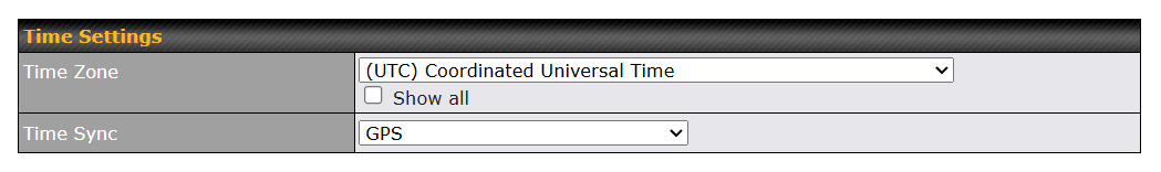

  1. Configure Time to us GPS only

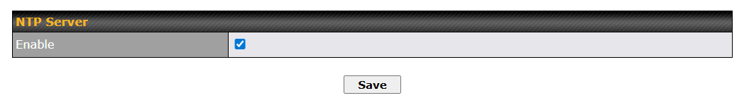

  2. Turn on NTP server

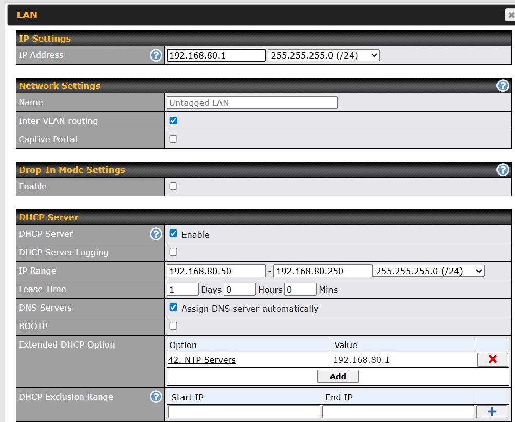

  3. On my untagged LAN, I have set extended DHCP options for NTP

  5. And finally, I have added the NTP Service Forwarding

I’m not really sure it knows what it is talking about as you have found the right config options to perform the redirection for “arbitrary UDP services”.
The bit about firewall rules might be correct though… see my comment further down.

This will only impact clients that actually ask for or respect the server you send them, some things may use whatever you feed them from DHCP and also continue to use whatever NTP server their OS thinks might be best.
Which rule list did you add this to, they relate to where packets are going from and to in different ways, do you see anything hitting the logging in the Events Log for denied traffic?
I’m not entirely sure to be honest where in the chain the service forwarder comes into play, either pre or post firewall rules… might need someone else to clarify that.
Either way your config apart from the firewall rule looks to be correct, though I’d again suggest there might be more significant things using up data in the background that would be better to try and clamp down on if you’re worried about burning cellular data - do you have InControl2 enabled for this device for example, that alone will use more data a day calling home by default I’d expect than a bunch of devices on your LAN making NTP requests.
