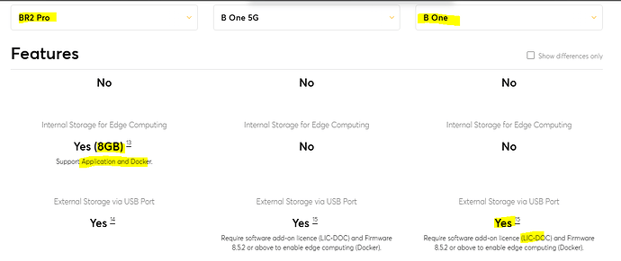

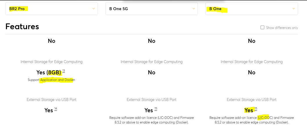

Some models with USB does indeed support Docker, but that’s generally not why it has a USB port. This port enables all sorts of other features (such as USB to Serial, additional WAN inputs, MAX Adaptors etc…).
You can view if a model supports docker under the Comparison Sheet online: Peplink.com - Model Comparison
Here you can also see that the B One & B One 5G does NOT support Docker.
Here example next to a BR2 Pro that does support,

If you connect a USB drive to the USB-C Port, will the B One support edge computing?
Hi Tim,
As per the latest update yes, with a license it will support Docker.
This was also demonstrated during the West Peplink Summit in Orlando in November, and available on all the lab kits bought.
