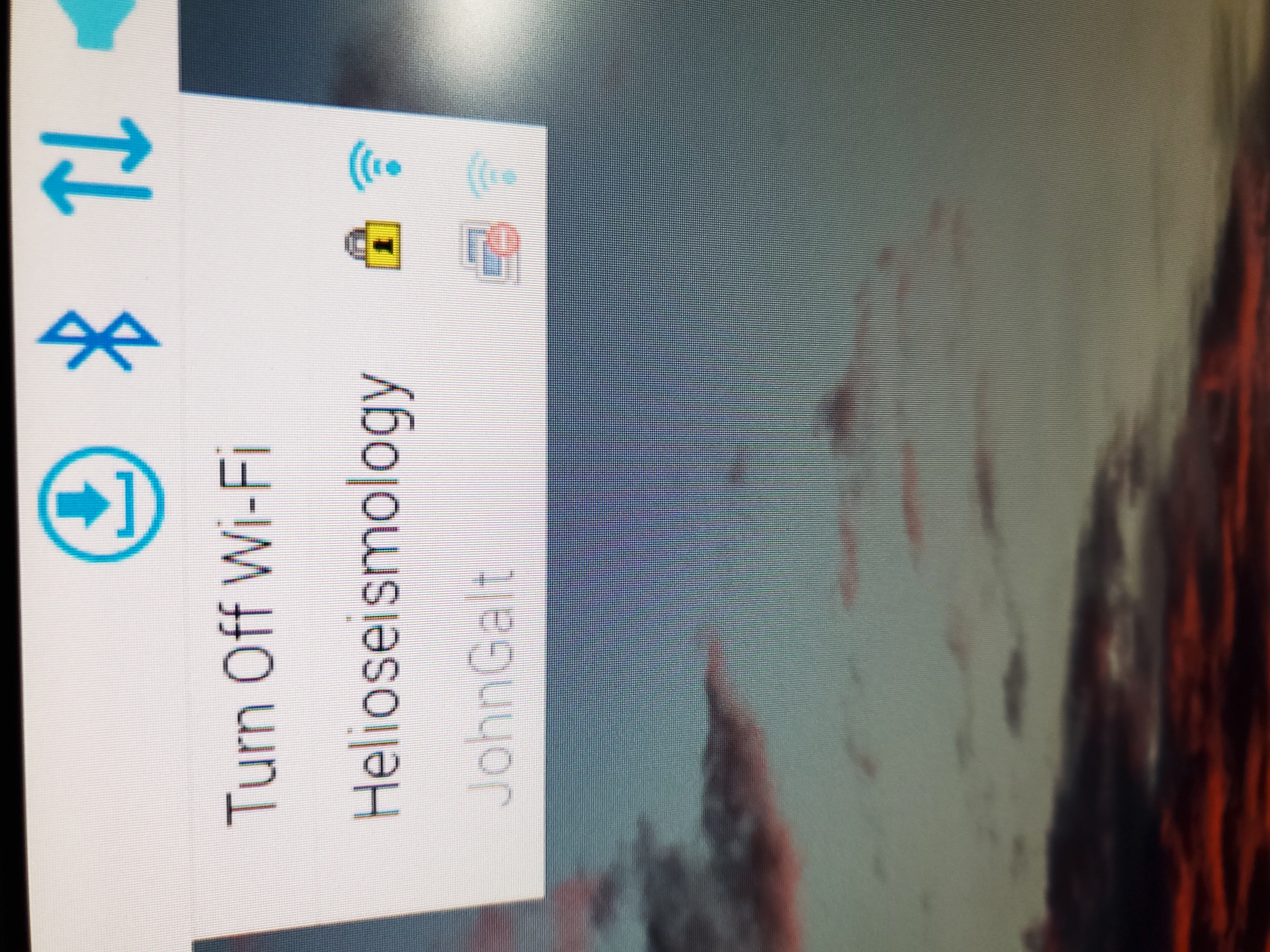

I want my raspberry pi 3 B 1.2 to use my wifi because of where it will be located. My raspberry pi can see both the ISP’s wireless router and the surf soho. But surf soho is grayed out and cannot even be selected. Does the Surf Soho’s wifi somehow look differently that anyone can think of?

As you can see from below the Raspberry PI can see both routers. I was able to tell the ISP what I wanted the SSID and password to be for their router. I told the Raspberry PI today to use their router and it was able to do so successfully. Even though the “sudo iwlist wlan0 scan | more” run from the Raspberry PI shows that it can see both routers. When I try to tell it to use “JohnGalt” (my router) it is grayed out. “Helioseismology” is not grayed out and my Raspberry PI can use it. Arrrgh!

ScreenShot of grayed out
I have edited /etc/wpa_supplicant/wpa_supplican.conf so that it has the correct information to talk to JohnGalt wifi. It is still grayed out.

I am sure this is not a peplink issue. I can connect via the Peplink wifi from both cell phones, an iMac, an M1 mac mini, and any of 7 Linux computers. I am just trying to figure out why my Raspberry PI can see and use via wifi a Gigaspire Blast wifi router and but not the Peplink. I am just puzzled why the Peplink looked different to the Raspberry pi causing the Raspberry Pi to “gray out” the Peplink wifi making it unavailable.
Things to check that can cause this…
  1. Protected Management Frames (PMF)
  2. Fast Roaming
    These features when turned on, can cause a client that doesn’t support them to not be able to connect. I don’t own a rasberrypi, so I don’t know which Wifi features it supports. Check to see if you are using WPA, WPA2 or WPA3.
