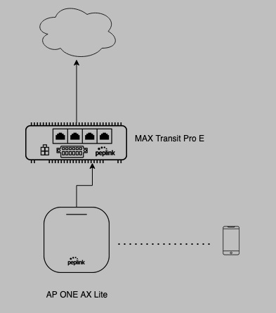

Hi! Yes, it should work on third-party APs. I can give a configuration example here, though as I don’t have a third-party AP on hand, I’ll use a Peplink device. Though it should be the same if any other AP would be used as the settings will be generic.
The setup will be:
Screenshot 2025-07-17 at 10.46.33
The captive portal will be configured on the MAX Transit Pro E and the AP ONE AX Lite will act as a generic AP.
Configuration on the MAX Transit Pro E:

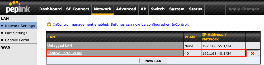

  1. Configure a VLAN that will be used by the Wi-Fi clients:

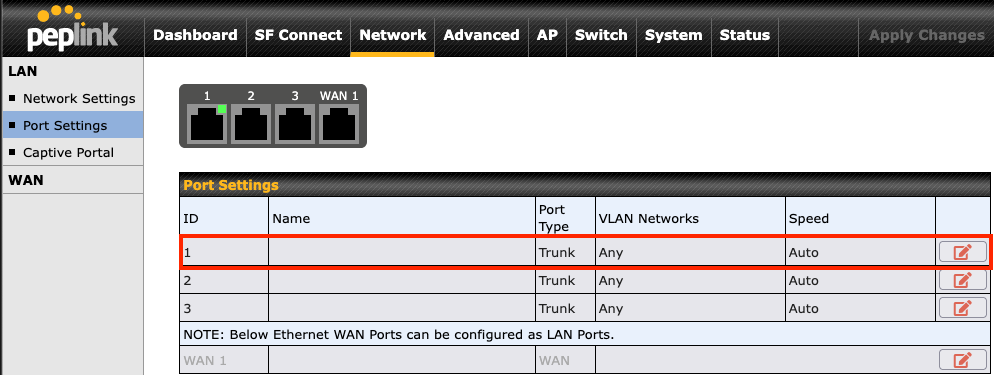

  2. Make sure that the port connecting to the AP is a Trunk port that allows both the untagged and captive portal VLAN:

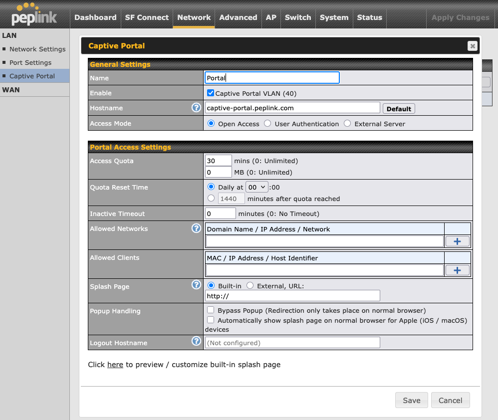

  3. Create the captive portal and map it to the created VLAN:

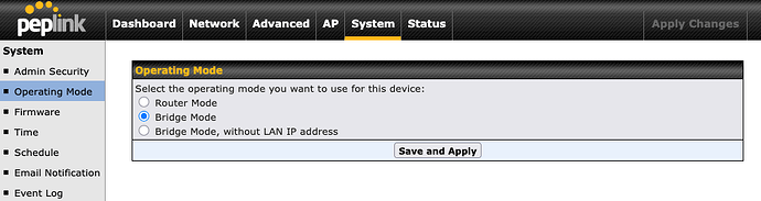

Configuration on the AP:
Basically you will need to set up that Wi-Fi clients would use the same VLAN as the captive portal VLAN on the MAX Transit Pro E. In the case of a AP ONE AX Lite, that would be:

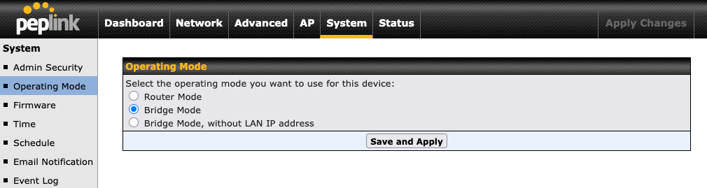

  1. Set it into Bridge mode:

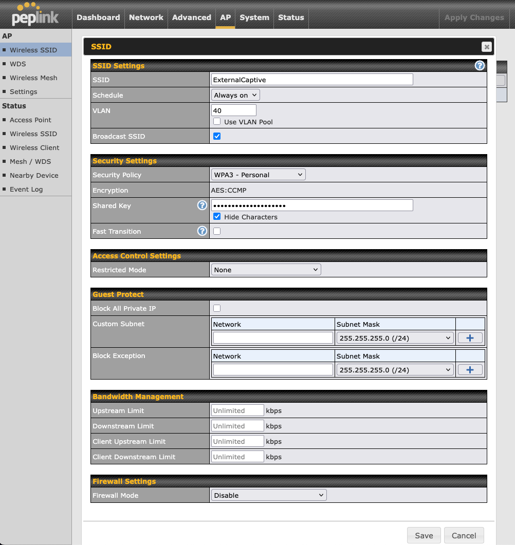

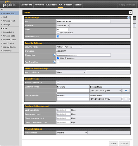

  2. Create a SSID with the same VLAN as the captive portal:
