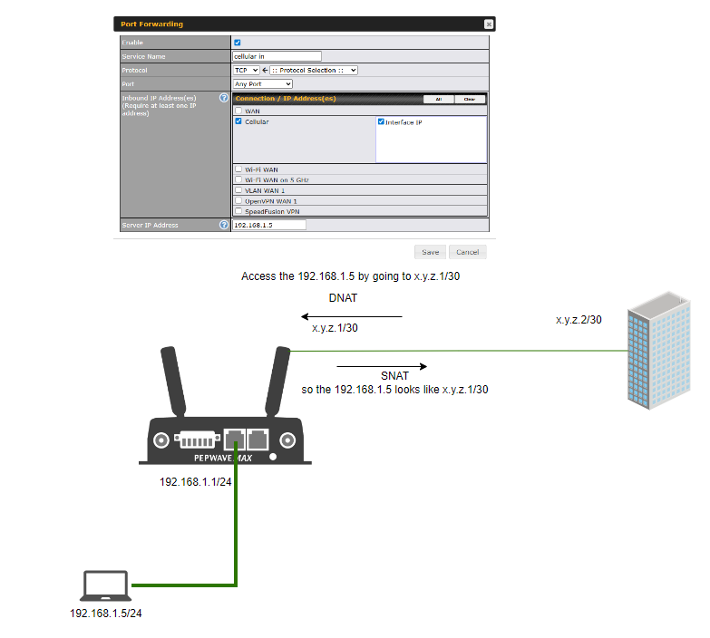

Hi John
I think I am missing something in this and it might be the how the M2M part comes into it.
The image is how I would expect it to work with the outbound traffic from 192.168.1.5 (I made up addresses for this) getting SNAT on to the x.y.z.1/30 network so the other end knows what to respond to, and then set an inbound port forward for all to the 192.168.1.5 from the cellular network.
Do you mean that you need the 192.168.1.5 address preserved onto the cellular network with outbound dnat?

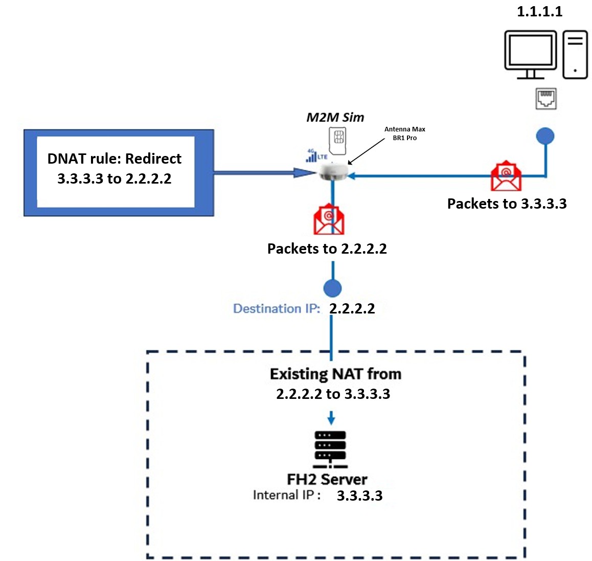

Hi Team, thank you for your response. Im attaching a diagram that may help to understand the requirement and below is an explanation on what we are trying to achieve.
Scenario Explanation:
  1. LAN Device (1.1.1.1)
  • This is a laptop/PC connected to the LAN side of the BR1 Pro.
  • It needs to communicate with the FH2 Server (3.3.3.3).
  1. Target Server (3.3.3.3)
  • The FH2 server is reachable only through the M2M network (2.2.2.2).
  • There is already an existing NAT rule in the remote network that translates traffic from 2.2.2.2 → 3.3.3.3.
  1. Peplink BR1 Pro with M2M SIM (2.2.2.2)
  • The BR1 receives traffic from the LAN device destined for 3.3.3.3.
  • However, the Peplink cannot natively DNAT this traffic directly on the cellular interface.
  1. Required DNAT Behavior:
  • Any packet from the LAN device destined for 3.3.3.3 should first be DNATed to 2.2.2.2 at the BR1.
  • Once NATed to 2.2.2.2, the M2M network will forward it using the existing NAT rule to reach the server at 3.3.3.3.
  1. Workaround from Peplink Support (Dummy WAN):
  • Configure a dummy WAN IP for 3.3.3.3 so the router recognizes it as inbound traffic.
  • Disable health check so the WAN shows as UP in the IP table.
  • Add a NAT Mapping rule: inbound traffic to dummy WAN (3.3.3.3) → forward to 2.2.2.2.
  • This allows the BR1 to apply DNAT, but it requires a physical WAN port to be brought up even without Internet access.
Let me know your thoughts and if you have other work around that we can try.
Ok I understand your DNAT requirement. Thanks for the diagram.
To be certain is the dotted line showing a NAT router? Is that where the existing NAT is applied?
Or does the FH2 (a Fusionhub server is it?) have a WAN interface of 2.2.2.2 and a LAN interface of 3.3.3.3?
If the latter then you could set the Fusionhub to IP forwarding and add a static route to the BR1 Pro for 3.3.3.3/32 > 2.2.2.2
To clarify, the FH2 server in the diagram is not a FusionHub. It is an application server that sits behind an existing NAT device.
  • The external IP of the NAT device (2.2.2.2), which is reachable via the M2M SIM and is pingable from the BR1 Pro.
  • The NAT device translates traffic from 2.2.2.2 → 3.3.3.3 (the internal IP of the FH2 server).
  • The LAN client (1.1.1.1) needs to reach the FH2 server at 3.3.3.3, but to get there, the BR1 Pro must first DNAT the traffic.
  • From there, the existing NAT device will handle the translation to 3.3.3.3.
So yes, the dotted box represents the existing NAT in front of the FH2 server, not a FusionHub setup.
