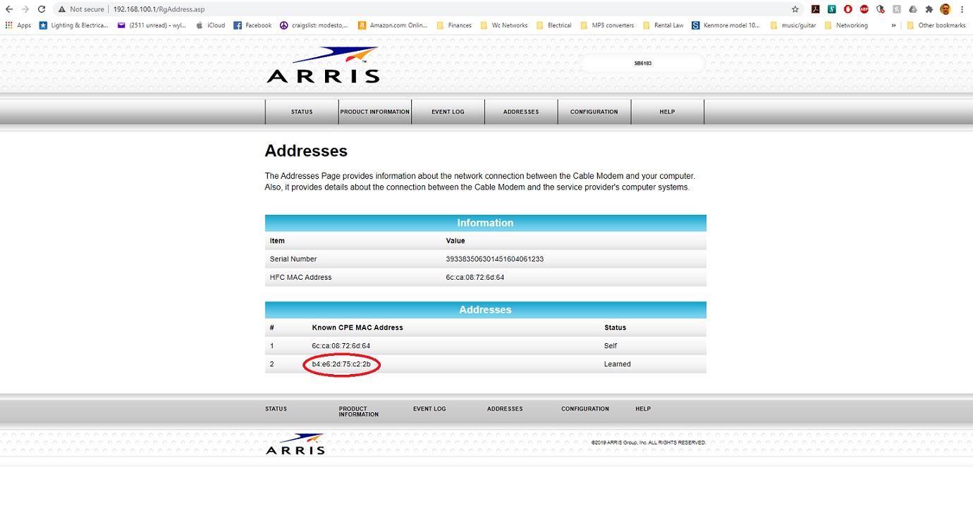

finally i decided to look at my modem logs to see if i noticed anything.
low and behold discovered that the “learned” mac address (should be mac of WAN port on router), was that of a wireless client on my network. this was really odd. the router was not passing its WAN mac to the modem. So i disconnected all wireless clients, rebooted, and still no comcast public IP. connected to modem and this time the modem had a “learned” mac address that belonged to the LAN mac of the router. WTH
so i cloned the LAN mac to the WAN mac and was able to get back online.
but this is nuts. MAJOR bug. see screenshots below…

  2. i did connect a computer directly to the modem and initially got an internal address (x.x.100.11) but then got a public address so it wasnt comcast.
  3. i rebooted both. rebooted modem then router.
cloning the mac address wouldn’t have fixed this since the router was passing the wrong MAC address to the modem for public IP DHCP request.
as far as blocking LAN devices from 192.168.100.1 there really is no point in that since those devices on that subnet would not be able to pass through the firewall. also, blocking that subnet means you couldnt log into your modem.
anyways, peplink got back to me already, logged into my router, saw the issue, tried to duplicate it in their lab and were able to. so they have acknowledged the bug and are working to fix it.
in the mean time, everything is working with me cloning the LAN side MAC so the cable modem issues a public address to the WAN port.
