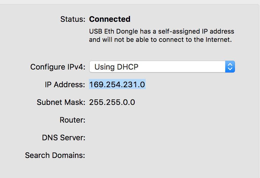

I was configuring a Balance One (Firewall, port mapping, etc). At some point, when I clicked the ‘Check for Firmware’ button, it crapped out.
Eventually I had to resort to pushing the ‘button’ for 10 seconds on the front to reset to factory default. I proceeded back to Firmware and manually uploaded fw-b1_210hw4_310hw4_br1ent_transit_m700hw3_hd2mini_hd4-8.0.2-build4407
Via the browser and ended up getting “Error 0: error” as the result.
Ended up doing another hard reset because I was not getting 192.168.1.x assigned to my ETH port when attached to a PepLan port.
As of right now, I’ve tried multiple different ETH connections to the Bal One and I alway get assigned the self assigned IP address (169.254.231.10) instead of one from the router instead of the expected 192.168.1.x with gateway 192.168.1.1. Needless to say, I can’t navigate to 192.168.1.1. When I ping it, I get “Request timeout for icmp_seq 0”
Can’t seem to access the router in any way??
This is what my network connector says when I connect to any LAN port on the Balance. (I’ve tried a Thunderbolt ETH adapter as well, same results. Both adapters work when connection to a separate, working Balance One.)

What is the status light indicated? Red or Green? Please open a support ticket here for us to assist you further.
Status light is green. (except when I reboot or hard reset, during which time it it red.)
I see the ticket 20040453 has been created, let’s follow up in ticket.
Corresponded with one of the PepLink people. Seems like my router has failed or is in someway bricked. Doesn’t seem like there’s a way to determine which.
