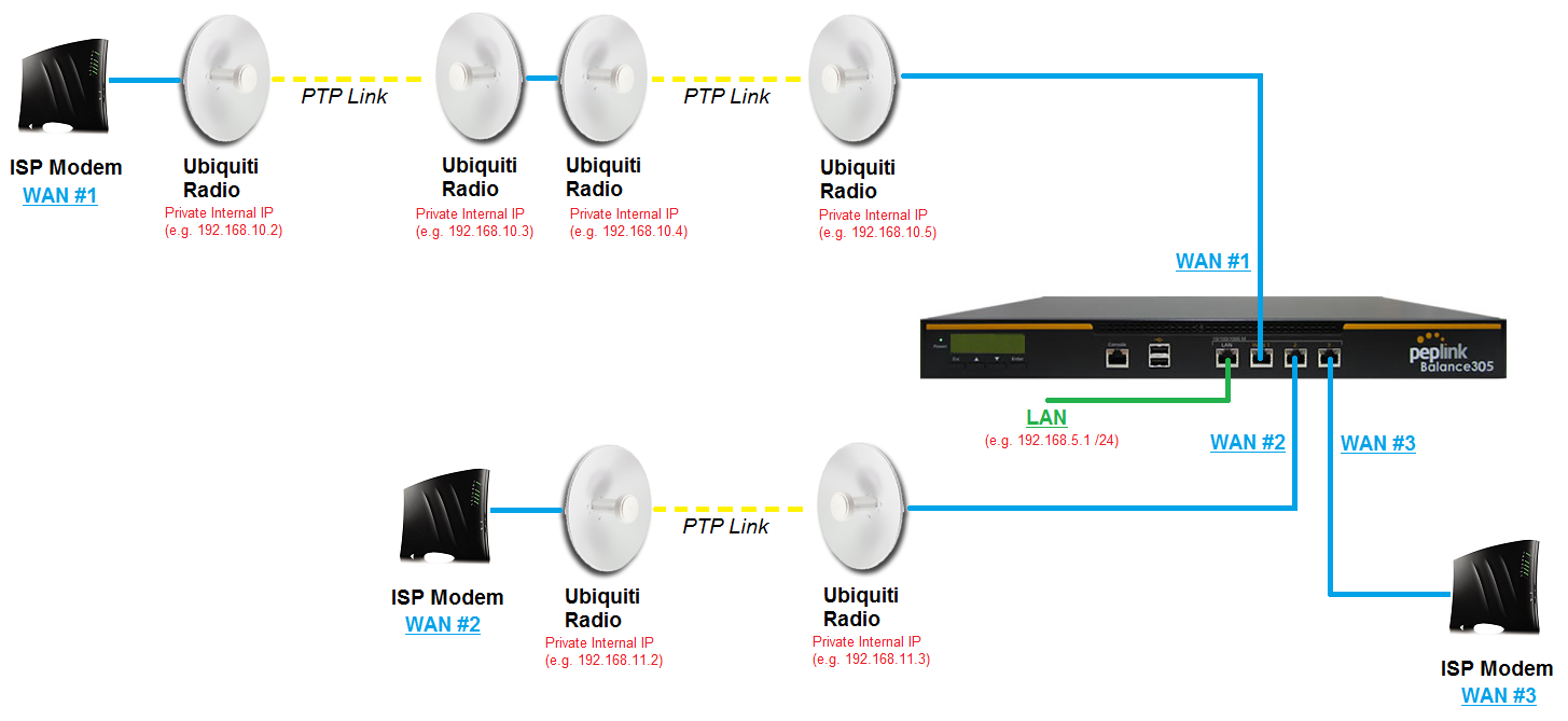

We are looking to add new WAN connections, but the ISP will be delivered to the Balance 305 over wireless PTP bridges using Ubiquiti radios. One of the WAN connections will be fed through two PTP links, while another WAN connection is fed over one PTP link. Please see the attached diagram which shows our desired setup.
My big question - Is it possible to connect to / manage the WAN-side equipment (e.g. modem and Ubiquiti radios) from the LAN?
Right now I have setup a PTP link as a Layer 2 transparent bridge and it successfully passes the ISP’s PPPOE connection to the WAN port of the Balance 305 (the router doesn’t even know that the PTP bridge exists; the WAN is configured as PPPOE w/ public IP and not Static IP w/ private IP) but I can’t figure out how to connect to the Ubiquiti radios from the LAN network. We need to ping and manage the Ubiquiti radios while they transport the WAN connections, and am open to creative solutions.
