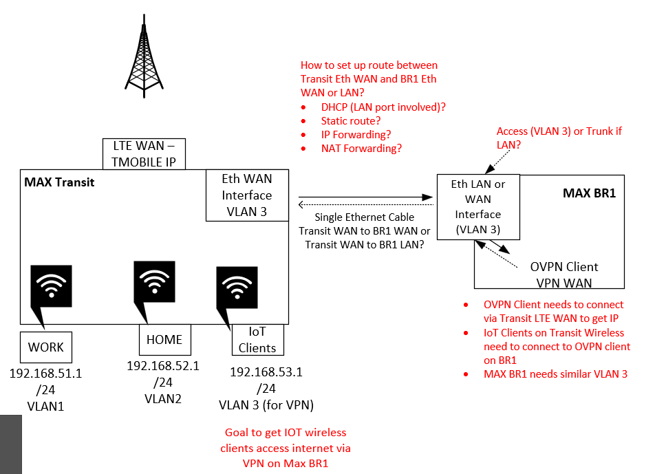

How would I link the Max Transit to the BR1 using Ethernet so that I can run OVPN on the BR1, but have it loop back to the Max Transit to broadcast VPN network via Wifi? Currently I’m not using any of the Ethernet ports on the Max Transit (cellular WAN only and wifi throughout house).

Configuration so far - because as described above confusing.
On Max Transit -
Network = IOT (for VPN-connecting devices). 192.168.53.0 / 24
VLAN = 3
DHCP Enabled - 53.3 through 53.15
Wireless Network:
SSID = IOT
VLAN ID = 3
WAN Port - Configured as LAN
Outbound Policy - Set to wired WAN for source IP network 192.168.53.0 = 100% (BUT wired WAN is now LAN port, so not sure of effect)
Default Outbound Policy = Cell WAN
On BR1:
WAN Port - Connected via Ethernet to Transit WAN (set as LAN) port.
Successfully gets IP via DHCP (53.13)
Outbound Policy -
Source = IP network 192.168.53.0
Weighted Balance - OpenVPN WAN (100%)
Networks - Non-except local lan access to access via LAN ports (192.168.48.1).
Open VPN does not connect. Sits and spins before ultimately disconnecting. Not sure what I’m doing wrong.

Desired config with questions given the above solution from ML:
Well - sort of got this to work with a static route between the two WAN ports, and NAT on both the BR1 and Transit WANs. The VPN client on the BR1 did connect and get an address …
But then I ran into NAT issues (double-NAT?), because although I could ping from the Transit to the mgmt host on the BR1 (as well as the BR1 WAN IP), I couldn’t successfully ping back the other way…
