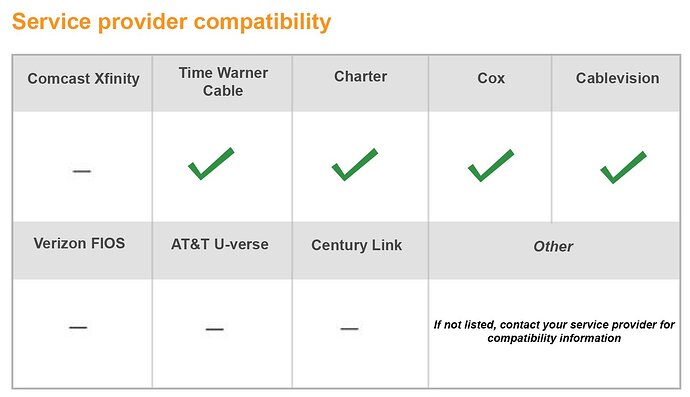

web says sb6141 not compatible with comcast
We had two of them in use for a couple of years with Comcast. They’re standard DOCSIS modems. Comcast does not want them on the system now as they are incapable of supporting their highest speeds. Restated: You can’t buy their higher tier services if you use this modem. It’s all about $$$.
was just going by this
