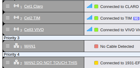

Hi, @demoh5115
Welcome to community…
I recommend MAX-BR2-PRO-5GN-T-PRM with MAX-BR1-MINI-5GN-T-M-PRM. (4G/5G LTE solution)
Using this solution… the topology will handle up to three simultaneous SIM CARDs.
To keep the management of topology simple as possible, you need to keep the Primecare. This way, you can use synergy controller solution and Incontrol2 for a remote management.
To boost the LTE signal, I suggest using the ANT-MB-40G-S-B-6 antenna.
This is a bit of an expensive solution, but it works well.
ksnip_20250807-122413
