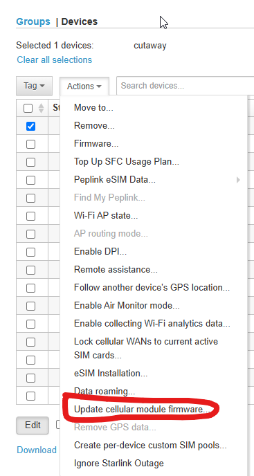

You can trigger the cellular firmware update from Incontrol2 as well. If you go to organization settings, device management, select one or more devices and hit the action menu:

@Topher, something needs to be clarified. Can I confirm the concern here is the cellular firmware upgrade with a single cellular WAN? If so, we have no problem upgrading the cellular firmware with a single cellular WAN.
