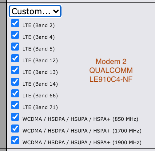

Modem number 2 is a Qualcom LE910C4-NF and the Hardware Revision is 10000.
And here are the bands available in each.
It would appear that modem 2 is the ideal for T-Mobile in the USA. Any suggestions about which modem is more ideal for ATT in the USA?
