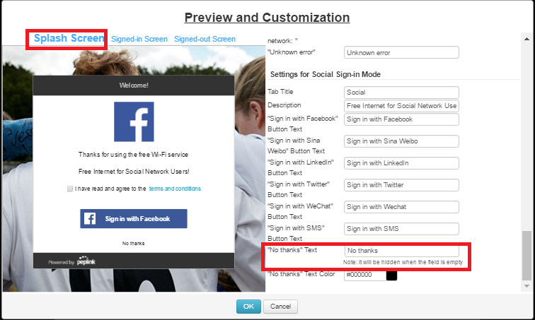

Hi,
The “No Thanks” can be disable by editing the Splash Screen page. For more information, please refer to the screenshot as attached.

I know that “No thanks” link can be disabled setting an empty label, but the issue is what “no thanks” link does… it permits people to use the network without any authentication… this should be said somewhere, that’s all
Thank you
Hi,
Thank you for the invaluable feedback. After discuss with Engineering team and we will improve this by adding a note next to the setting that explain the “No thanks” field.
