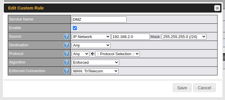

These are the settings of the enforced policy for this WAN2. They are pretty standard I suppose.

You can also change your IP in the outbound policy from 192.168.2.0/24 to 192.168.2.1/24 and give that a go.

He said I “can”, not I have to make it work. I know I can. So my question is. Should I? And yes, the IP is fixed in the Outbound policy.
