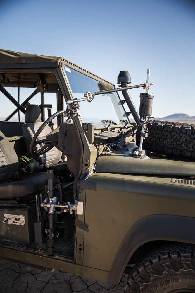

So in my configuration (which on location in a desert shoot looks a bit like this)
My network is as follows:
iPad connects to router via WiFi
Teradek Sphere connects to router via Ethernet cable
ZCam S1 camera connects to router via Ethernet cable
Windows laptop connects via WiFi
All these devices need to see each other.
