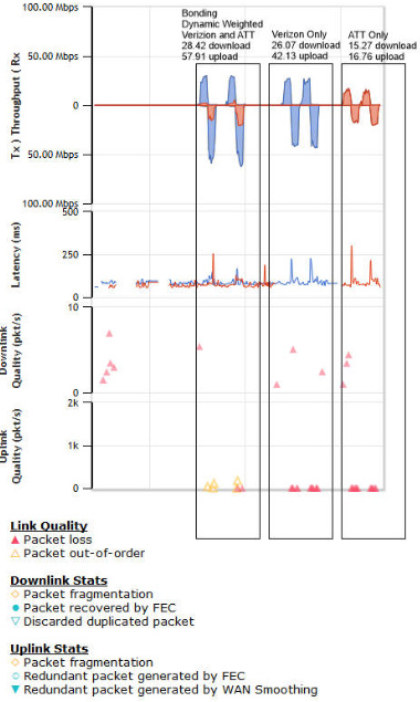

So I’m wondering if I can make some headway bonding cellular with speedfusion to increase speed.
I’ve tried a couple times before, but not been successful getting a faster speed on the download side.
I’m running speedfusion on a balance with two pepwaves each with a cellular connection and a fusionhub solo in the cloud.
I currently have a data plan with verizon and one with AT&T prepaid.
When speeds are good I get
ATT 55 mbps down 12 mbps up
Verizion 45 mbps down 40 mpbs up
When things are bad I get
ATT 8 mbps down 4 mbps up
Verizion 5 mbps down 30 mbps up
So the problem is using a single cellular, there’s no way to know if something will be quick or sloooooooow.
With speedfusion I can make the connection unbreakable, and I can bond on the upload side to get faster than either individual upload speeds.
But I seem to do better on the download side manually plugging into the faster (at that time) of the two cellular and using that one only. (or setting it with wan1 priority 1 and wan2 priority 2 so it will fail over to the other cellular if the first one goes offline entirely. But it seems actually slightly faster to use one cellular than two cellular connections bonded, on the download side.)
The problem is when I need a single largish file, like a 150 MB file, it often downloads at 1 MByte per second or slightly less. Sometimes I can speedtest the other cellular and it’s running individually at 40 mbps down, but I don’t have a way for the balance to know that the one link is “slow” and to use the faster cellular at that moment it seems. I’m a single user, and need the bandwidth for a single task at a time, like downloading a single 150MB file as quickly as possible.
Any suggestions or success stories on how to achieve faster download speed using two cellular connections and speedfusion?
