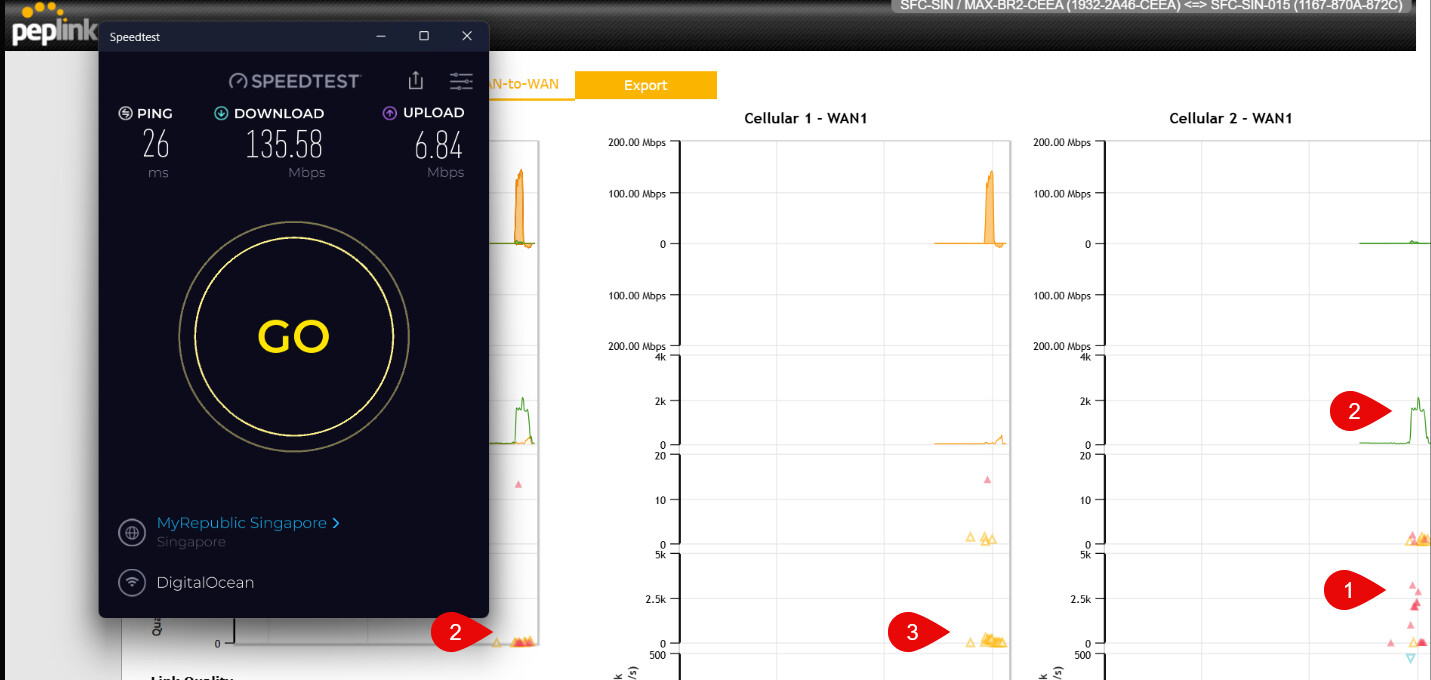

Whenever i do a ping test to google. there will be ‘request timed out’ displayed for 1 or 2 lines when i drag one connection to disabled. is this normal? it will just be continuous when i drag it to standby instead.
I am not getting a speed ‘boost’ when i do a speed test . i understand it is caps at 200mbps for SFC connect. however the test results doesn’t seems favorable for me to showcase. I would just like to show that with DUAL SIM Connection bonded, there will be a speed bump.
Looking for any expert advice, please correct me if my understanding is wrong or is there any ‘wrong’ configuration Thanks!

hi @MartinLangmaid . this is the SS .
hi @MartinLangmaid , could i have you advise on what went wrong? thanks!
  1. Cellular 2 has tons of packet loss
  2. There us also considerable latency making it fairly useless
  3. Speedfusion is trying not to use it becuase of the packetloss
  4. Cellular 1 has out of order packets (I expect its a roaming SIM or MVNO SIM?) oop impact latency of the tunnel
I can’t see the bottom of the graphs - are you using dynamic weighted bonding? Is FEC working hard on cellular 1?
all are local SIM from Singapore not on roaming.
SIM 1 is on a Prepaid from Main Telco. Not MVNO. 5G SIM
SIM 2 is on MVNO. 4G only.
Yes i am using Dynamic Weighted Bonding . FEC is not turned on.
