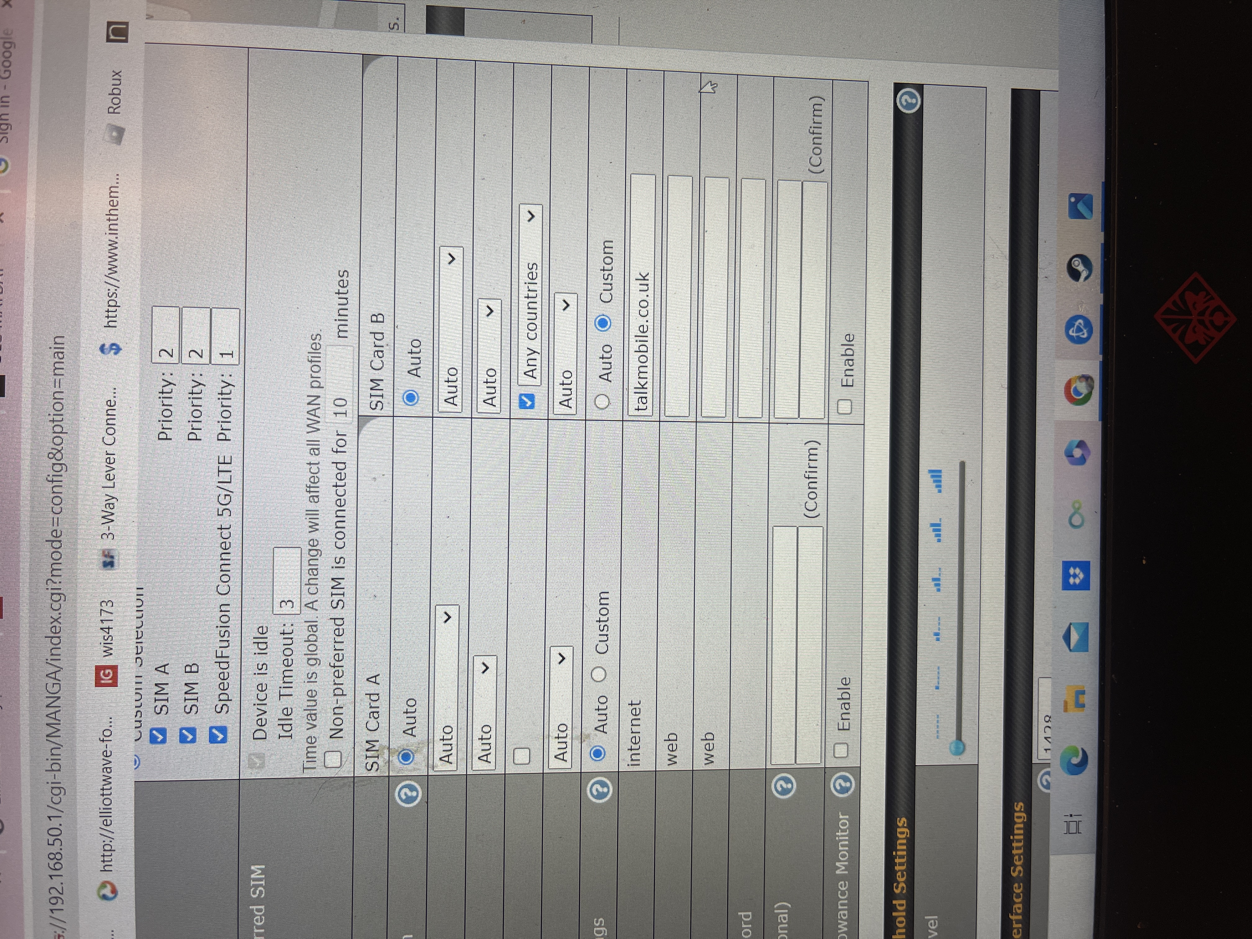

Hiya cheers for the reply’s, Iv just tried changing the custom settings and I cant see where to put the access number , Iv Tried changing the apn, but the sim still
won’t work, any ideas
From your screengrab, you show the talkmobile.co.uk apn in SIM B. Is that the slot the SIM is in? If so for testing I would untick SIM A and the SpeedFusion connect SIM checkboxes so make sure you are testing that SIM specifically.
It can take a surprising amount of time to try all the SIMs otherwise.
