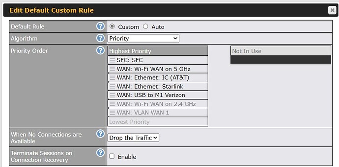

I have a very simple, quick, and no cost solution that works for us and may work for you. I have the default outbound policy to use SFC for all traffic; however, I also set up an outbound policy to exclude web traffic from using SFC. We no longer have issues with websites blocking us. Also, we have not seen any issues without SFC on web traffic since a glitch here & there is recoverable and hasn’t been noticeable after using for months now. Because of the default policy, we still have SFC for everything else which includes critical real-time applications like Zoom, VoIP, etc. Hope this helps.
Your rule just sends all traffic over WAN1, and then WAN2; this doesn’t seem to apply to only web traffic. What other rules do you have, and what order? can you show the other rules? I am having a similar problem but did the opposite; I am telling my VOIP traffic to use SFC and everything else to use WAN1, and then WAN2. But I’d prefer to do what you suggest, but I don’t see how that would work according to your screenshot, thanks!
Ryan2,
Assuming you are referring to the outbound policy I posted, let me expound on my solution. First, I set up the default outbound policy (below the added policies - easy to miss) to use SFC as the top priority. See the attached. Second, I set up policies to exclude scenarios where I didn’t want SFC to be used. The above is a policy to exclude all TCP (ie, SFC is not in the priority list). I have another to remove my Roku device because that’s just a waste of data and buffering gives me smooth video. I have a third to exclude another device that should never needs SFC.
I originally tried to do the opposite (only use SFC for Zoom, VoIP, etc) but the same protocols for Zoom seem to also be used by other non-critical video like YouTube, social media, etc. So I switched to SFC by default and excluded protocols and devices that didn’t need them. I’ve tested these and they work as intended.
