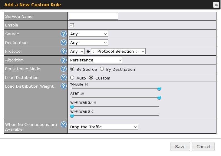

I am currently trying to tweak the traffic going in and out through our system.
The system is the following:
1 MBX CAT18 with 2 Cellular Modules being used (8 antennas)
2 x HD1 with SIM injectors which are connected to the WAN ports.
As I experienced, Whatsapp Videocalls have momentary disconnections and sometimes you must restart the call so it connects.
I believe this is caused by the MBX trying to forward the packets on different cellular modules.
I would like to know which kind of Algorithm would you recommend to improve the call, currently using Lowest Latency.
