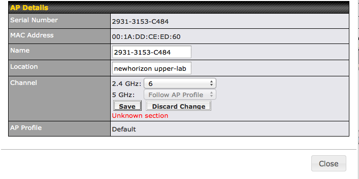

Thanks for the response Lewis. Based on your info, I think auto power and manual channel assignment make the most sense for my environment.
I’ve tried doing manual channel assignment but am getting the message ‘error unknown section’ when I attempt to save the change … Any clues about that? I’m using balance firmware 6.1.0 with pepwave ap-one in-wall’s with firmware 3.4.0…
Here’s an image of the error:
Would you please turn on Remote Assistance of your unit(Both AP One and Balance)? And then, please create support ticket here. We would like to look the issue further.
