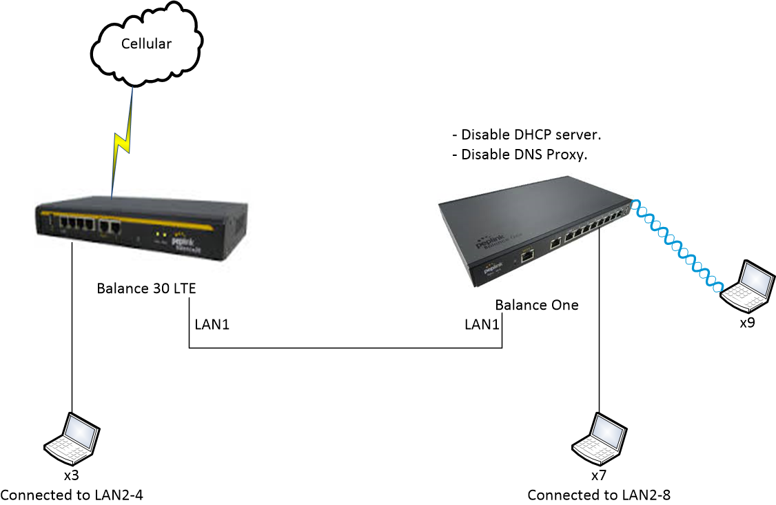

Please find the diagram below. Balance 30 LTE will act as DHCP server, DNS server and gateway for all LAN hosts. Does this meet your requirement since Balance One was purchased?
