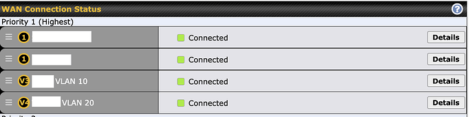

I am running a 20x with 4 Wan connections, using VLANS so far so good. I am using USB + Default WAN + 2 virtual WANS. non of my connections are that fast but I can confirm that I am able to hit 400-500 combined across all connections during the late evening hours. This is all ISP limited not peplink in my case. It have not read of any speed reduction from the quoted 900 Mbps so I am assuming that is not the case especially since mine are running on VLANs on a different switch. 20x has become a utility system for me. I tried TP-link previously and there LB was ok but would have random disconnects that I could not explain. Since upgrade to Peplink those are gone so I guess problem solved.
My connections are
WISP, WISP, Verizon, Starlink.
