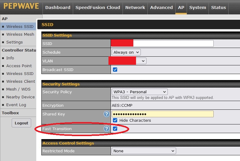

I have a balance one AP Controller along with several AP One Enterprise. My issue here is that while moving on the yacht from cabin to cabin and while there is wifi coverage my iphone will not connect to the AP with the strongest signal but rather keep a connection to the AP with the the lower strength signal and at some point eventually will move to the AP with the better signal.
As this affects VOIP calls etc. with the disconnects and while i have tried to allow only e.g 5G band with 80MHZ width is there something else i can check?
Thanks.
Thanks Metz.
The way we test is by using two iphones connected via wifi on the same SSID and starting a facetime. One remains still while the other is moving. On certain points and while there is coverage the signal is getting completely lost.
Forgot to mention that on balance i have enabled on the testing SSID both 2.4Ghz at 20Mhz with Auto channel selection and 5Ghz at 40Mhz again with Auto channel selection. Power is both MAX with boost enabled.
Would also make any difference at all if i configure Client Signal strength Threshold with a value of 30 or 40?
TBH i thought that with Peplink seamless roaming would be easier…
