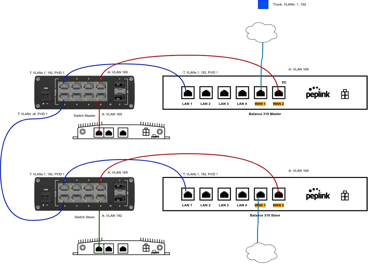

Can you share your setup details? Mainly need to know which Ethernet ports are used and their negotiated speed. We will make same setup locally to check it locally. I would like to make exact same setup as yours in office.
Hi Giedrius,
This setup has been running idle for a few days but getting very hot:
All ports are negotiated at 1 Gbps.
Recently, I replaced the Teltonika switches used here by Peplink SD Rugged switches mounted together with the B310s in a 19" rack with open doors, making them even more crazy hot. No load on the machines in term of traffic, but these are on 2.5 Gbps for the WAN ports and 10 Gbps for the LAN ports.
