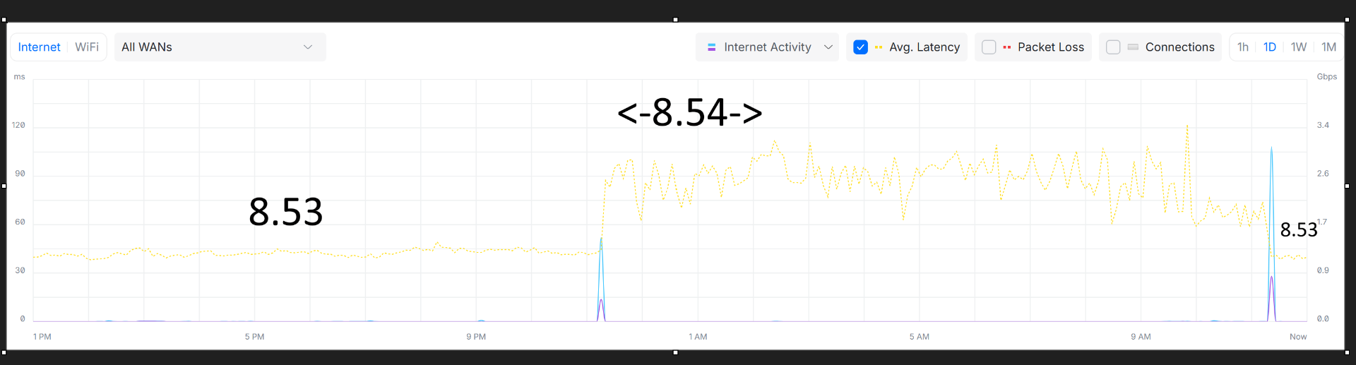

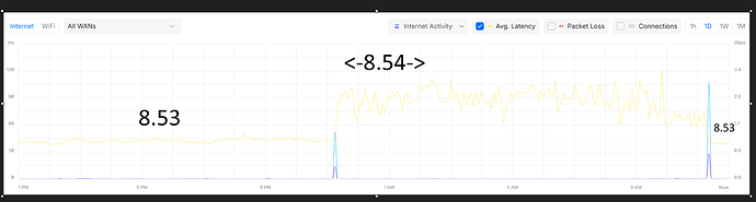

Hi Beau - thanks for the reply. What I’m seeing is overall general latency of my Speedfusion Hubs when on the 8.5.4 firmware. I’m not even using the VLAN WAN. Just WAN 1 and WAN2. Below is a picture illustrating what I see, latency is sub 50 ms on 8.5.3. Then nearly doubles on 8.5.4. The yellow dotted line is latency. Last little stretch is where I reverted back to 8.5.3, and it’s continued the same.
I rebooted everything in the chain after the 8.5.4 upgrade to no avail. Not sure what is different .3 vs .4 that would cause latency to shoot up. The other odd thing is the latency is erratic on 8.5.4 vs. pretty consistent latency on 8.5.3.

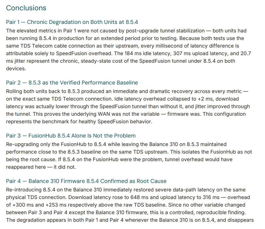

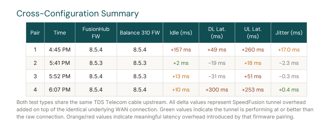

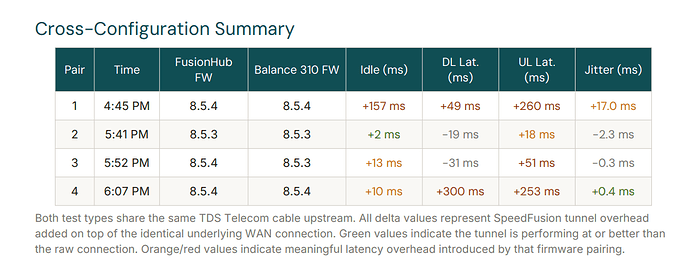

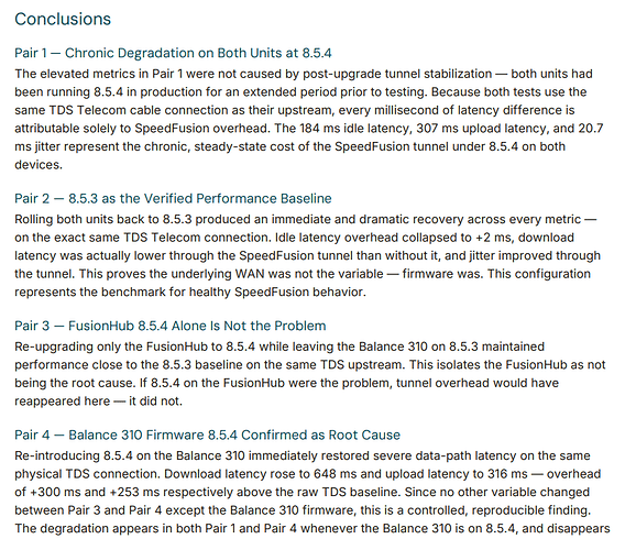

You’re welcome and thank you for that clarification. I was able to reproduce and generated a pdf report from my test results - with some help from Perplexity - and verified the data. :slight_smile:
It seems clear that having the 310 on 8.5.4s022 build 6297 is a root cause. The forum won’t let me upload the full pdf report but I can email it to you if you want it - just dm me where to to send.
Here are the relevant snippets;
This is fantastic! I will DM an address to send. I have a ticket open with Peplink and I will combine your data with mine so hopefully that helps them find a resolution.
