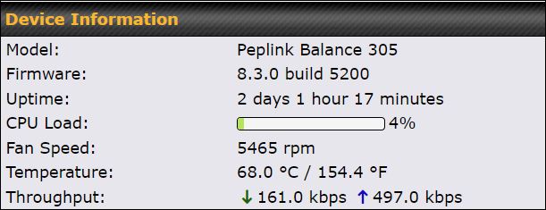

For the sake of comparison : I have a Balance 305 that operates at very moderate load (typically <10% CPU load) and also shows a reports a temperature that is somewhat concerning.
My device is mounted inside a closed 19" rack with some other network equipment. The rack is ventilated, but the ambient temperatures are on the high side, typically around the 30 deg C mark. Under these conditions, the device reports temperatures of between 60 and 70 deg C. Fan speed is typically around 5000-6000 rpm.
20220306 snapshot.JPG|611x235
From the value, one assumes the sensor may be measuring the case temperature of one of the chips rather than an “internal case ambient” temperature.
So far no issues, but personally I would be happier to see this figure lower.
