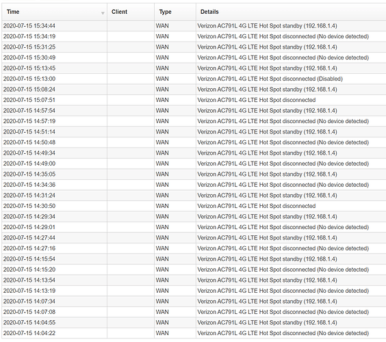

We’ve got a Balance 305 with a Comcast primary connection and Verizon AC791L backup. This is a failover connection with the AC791L on standby.
We’ve got this set up and tested working for a few weeks. However, after about a week of standby time, we start getting frequent connect & disconnect events. Has anyone had a similar experience? The only thing that stands out on the modem is a message about battery longevity mode.
The verizon AC791L is not intended to be always on, they tend to be really hot.
I would recommend a pepwave BR1 mini linked from lan to WAN2 of your peplink balance 305.
Second that - we gave up employing AC791Ls because they would not reliably stay up (and would require a manual intervention to be made operative again).
Hello and Good Day
We used one for about three years. They can run all day.
Make sure it’s in tethered/charge mode if that’s the way it’s connected.
Eventually the battery will swell from being connected all the time. It should be replaced if that’s happening.
Also make sure it’s firmware is updated.

@Ballistic, I wish we had the same behavior as yours. Are you on Verizon? I researched the issue and apparently it’s a common AC791L problem. I am on the latest Verizon supplied firmware. Did you update to a Netgear firmware or similar to achieve this?
