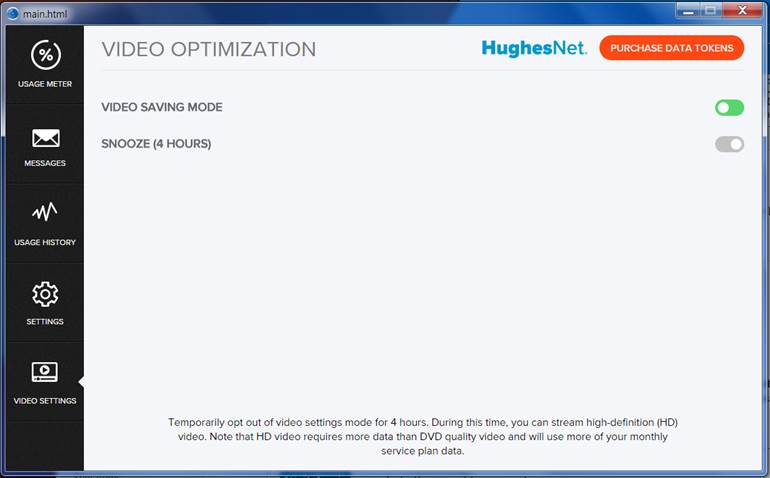

There is an option on the HughesNet to changed how “video” is handled. Here is what that control panel looks like:
and here are some testing results, NOT with the Peplink in the system:
Since we are in the 20-day no charge period I did some research on HD versus SD (Video Saver)
Set to “Snooze” runs HD: AMZ Fire stick on Netflix 1 hour HD = 3.3 GB (Full HD great video/sound)
Set to “Video Saver” runs SD: AMZ Fire stick on Netflix 1 hour HD-over SD = 1.6 GB (Pretty good video, better than SD normally is… audio good.)
When you do Videos on Computer (You Tube, embedded on HTTPS) you get the following results:
Set to “Video Saver” mode. You Tube: The USAF Band - 2014 Holiday Flash Mob 6 minute normally HD now playing in SD mode (You Tube sets back) Audio fine, Video @ 360p – poor images. Use is 30 Mbyte of data for the six-minute program. (300 MB per Hour) -
Set to “Snooze (HD)” mode. You Tube: The USAF Band - 2014 Holiday Flash Mob 6 minute now playing in HD mode (You Tube sets back) Audio fine, Video @ 720p – high quality images. Use is 120 Mbyte of data for the six-minute program. (1.2 GB per Hour) -
Test results above using computer HTTPS comes out to 4 times more video. On the Fire Stick comes out to be closer to 2X more data video. And this is relative.
So watching an hour of videos on the computer = 300 MB in the 50 GB allowance, if that was ALL one did that would make the 50 GB last for 167 hours (5.5 hours a day per month). I think between us both it is unlikely that we will do that much “video time”. Non Video Browsing is less consumption, like email, etc.
So the HD setting uses MORE compression, and the SD or “Video Saver” mode does less compression … I suspect ANY compression is not liked by the Balance 30 given the 50% reduction in throughput.
