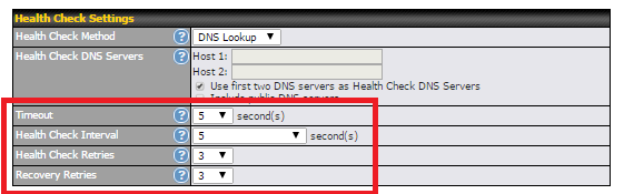

You can fine tune the WAN health check settings to improve the fail-over time. For more information, please refer to the screenshot below:
To achieve seamless and Hot Failover you may consider to use Peplink SpeedFusion solution.
