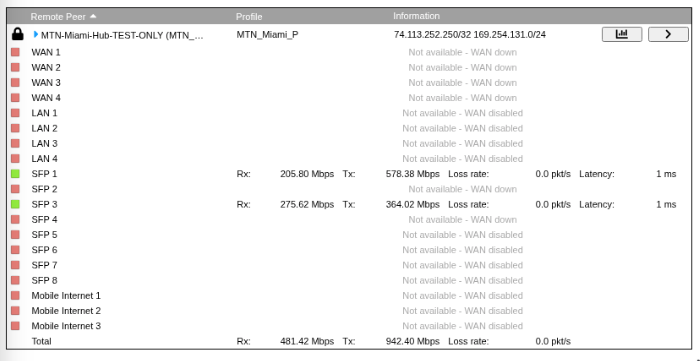

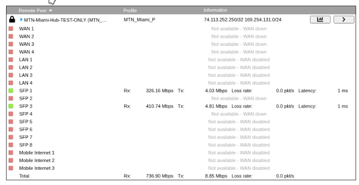

Download Only

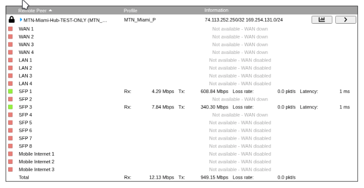

Uploading Only
bi-directional Traffic. - TX-RX
