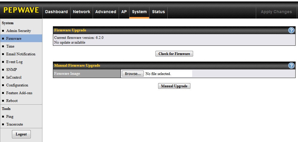

Then a final option could be to upgrade the firmware to a latest version:
You mentioned you have this Surf Soho for 5 years already, I suspect this is HW Revision 1, so the latest version is 6.3.5.

When I select “Check for Firmware” the response is “No update available”.
