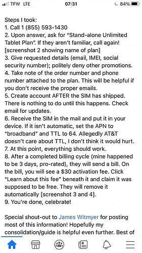

Here’s the specific instructions from a Facebook group that worked for me.
Sometimes it’s easy, sometimes it’s difficult. It can be a tedious process because they do a credit check so you need SSN and driving license numbers ready. I had to do it twice because after the order is created you receive an email with a link to order status which has a link to a form to accept the terms and conditions “before we can complete the order”. That form didn’t work for me. It returned a big red TC009 error. Calling support just ended up going round in circles getting nowhere. That order was canceled overnight. I ordered again the next day and got the same problem with the T&C form but a few hours later it shipped. Some people have reported going through the process three times and hitting the T&C error every time and giving up in frustration.
The whole concept of needing to verbally exchange long numbers with someone on a line with poor audio quality, possibly in a different country with a potential “accent barrier” pretty much sums up AT&T. That said, the sales people I got both times were really good. They knew exactly what I wanted and it went quite smoothly. Other people report calling several times and being told that there is no such plan.
