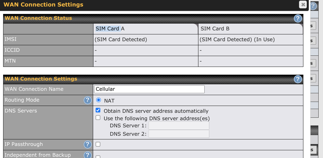

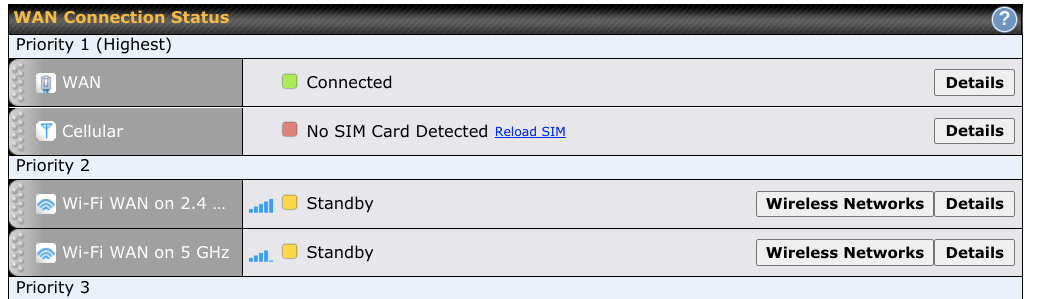

well mobile must have had me go back to firmware 8.1.1 so if att would work on that but now i get this
so i have no idea whats going on with me unit side note at the is a Tmoible sim and ATT sim

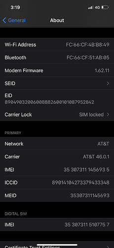

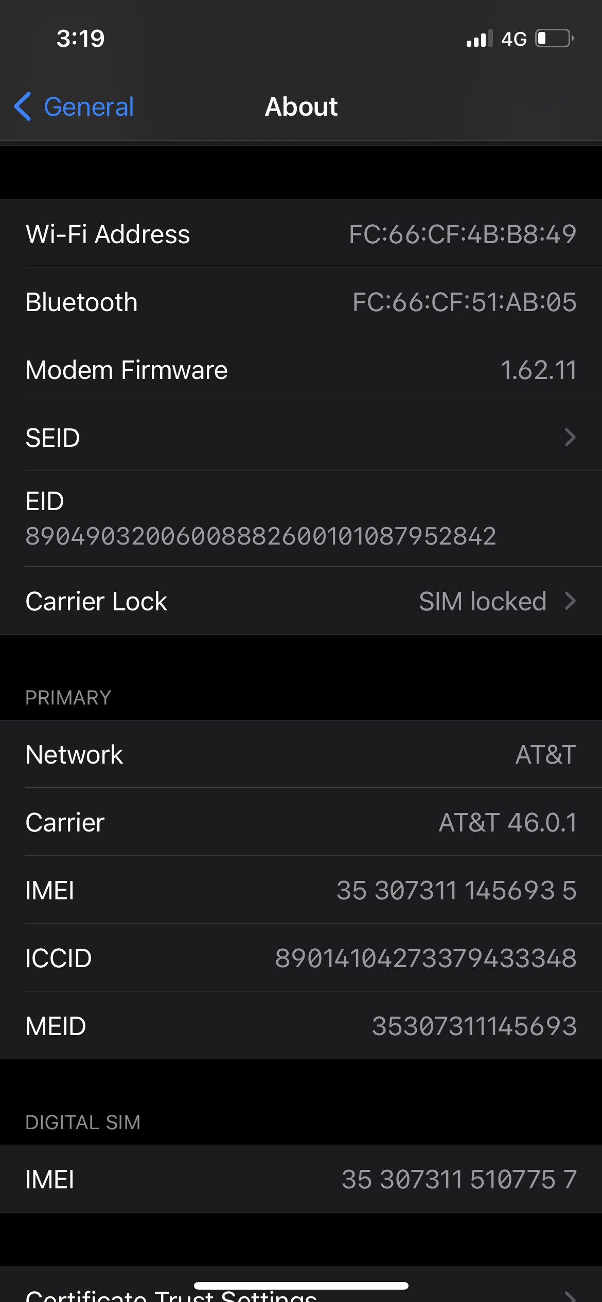

Not sure what we’re looking at here; the conversation is in regards to AT&T pre-paid with Peplink hardware, not a phone.
I am at art right now and just found out that all prepaid data will NOT give you 5G service only postpaid plans will give you 5G
