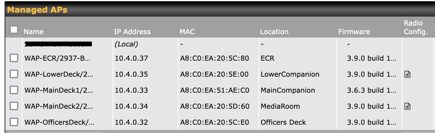

The issues I have are the range doesn’t seem to be nearly as good. It’s not uncommon for me to find up to 5 or 6 devices with -90dB*(1). Also the AP’s seem to be going offline and coming back online repeatedly through the day which I suspect might be a source of some of the complaints *(2).

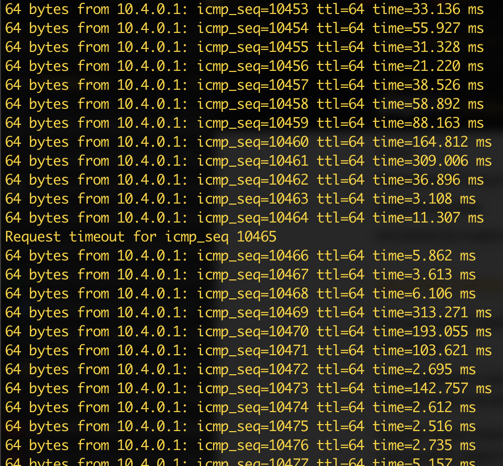

But the downside is I’m still seeing lackluster performance. The latency is immensely high and there’s packet loss when pinging the router (the Transit Duo) which has an under utilised 24port switch between them with nothing else plugged in.

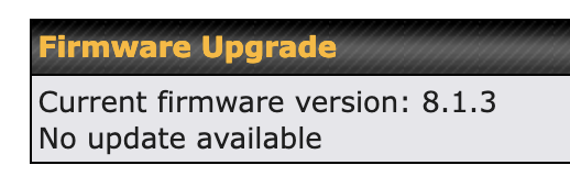

Firmware all up to date. First thing I did.

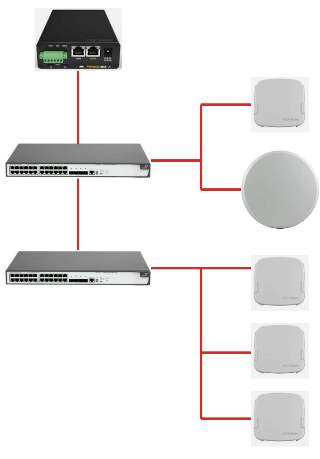

Our network topology is rudimentary:
I’m currently sitting 2 metres from an AP One AC Mini and still suprised at the fluctuations in latency and packet loss when pinging the Transit Duo Router; 10.4.0.1.

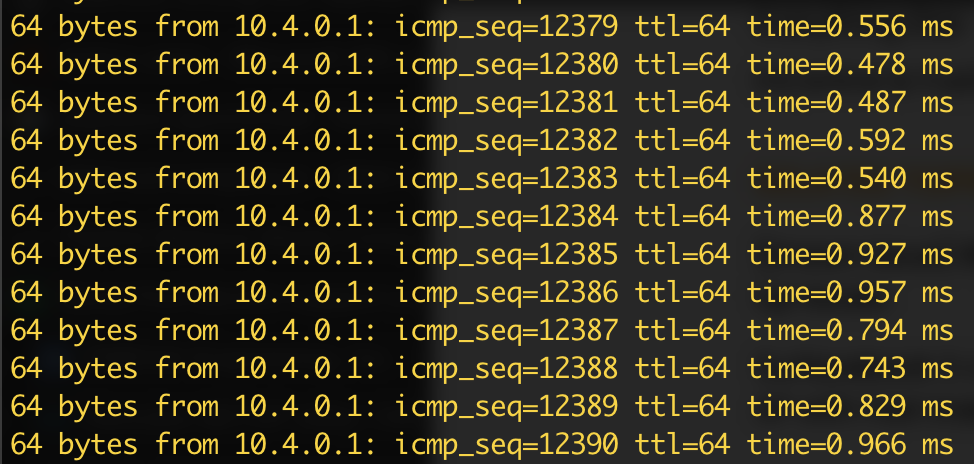

When I plugged into the network with a cable earlier the results were as expected:

Your jitter is looking more like a client wifi device dying. I have a 2013 MacBook Pro that is barely holding on – the antenna is tucked behind the only moving part of the laptop - the hinge. I can “jiggle the handle” and influence the wireless performance.
My point – try with a different wireless device and see if it behaves the same way. I chased my tail for weeks over a loose antenna connection inside the hinge of my laptop. Nothing on the mac indicated any faults with the hardware – I would just get really choppy audio during Teams calls, web pages timing out (or parts of web pages timing out), and my VPN would “reconnect” often. I plugged in a wired dongle – no more issues.
