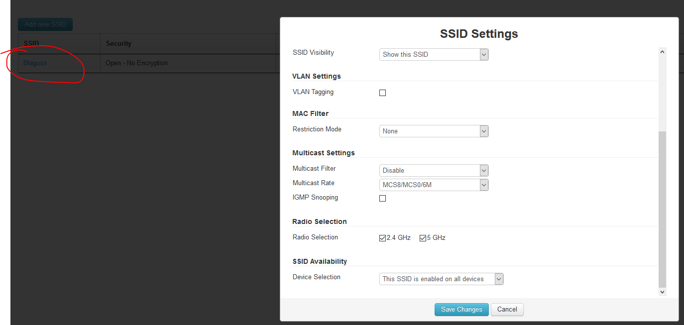

Hi, I have the same problem that the captive portal option is nota available in the SSID menue. I use an Pepwave MAX HD2 with his internal AP -NO external AP- so the router and the internal AP are in the same group.
the strange thing is: the SSID is not shown in de portal configuration , but the captive portal is working.
That doesn´t look so good…
where can i find a solution?
Best Kai
For latest IC2 version, captive portal settings for Balance/MAX and APs are configure in different pages. Would you please confirm ? If you have only Balance/MAX device in the group, then SSID captive portal settings won’t shown. That is normal.
MAX/Balance device is configure at VLAN settings:
APs device is configure at SSIDs:
Thanks for your advice, finaly I got the captive portal to work without problems, made a two day test and it works fine. It is only irritating that the SSID is not shown as you can see in the picture!
