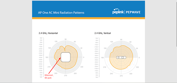

My site has 3 levels and is laid out horizontally wide enough to require 3 APs to cover. I have the APs laying flat but was considering mounting them vertically. Do they broadcast and receive equally in both planes?
Please refer to the radiation pattern below.

Wow! Are you folks using an isotropic antenna?
This is valuable information. The pattern is greatly different than we had expected!
Rick
AP One AC Mini is using inbuilt Omni Directional antenna.
@TK_Liew This is great, thank you so much for these pattern plots! Awesome service I must say! Can you tell me for the AC_Mini horizontal plots what the side with the ethernet and power port is? This is important, as one side has a big null at about 95 degrees.
@barthold, here you go.
Awesome, thank you!
