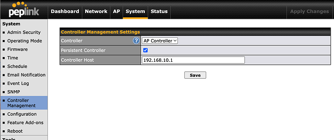

Hi, I have selected AP Controller in controller Management in my new AP-ONE-Rugged. I have also selected Persistent Controller and given the IP of the Balance. But it doesn’t get recognized in my balance 380. I have 9 other APs connected to the balance and they work perfectly. Both devices can ping each other. I must add that it appeared one time in Access Points as a offline AP but it did not have any IP assigned. So I clicked Removed offline units hoping that it will have the correct IP and come online after a AP reboot. But it never appeared again. I have also restored the AP to factory defaults without any avail. I plugged in a new Pepwave AX-One-Lite to the same Balance and it automatically got configured right away.

Did you log into the AP One and enable controller managment? System > controller
Yes, I did.
