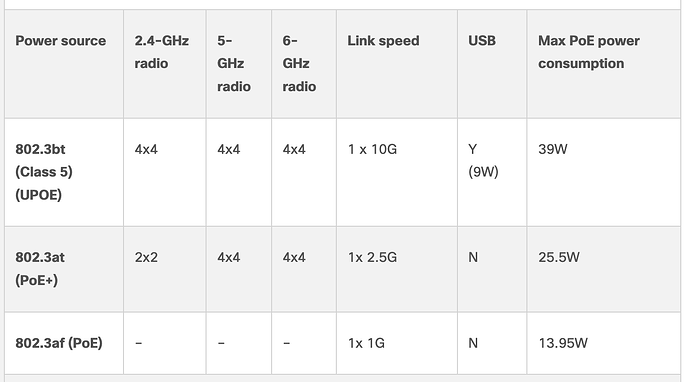

One area of concern though is around what happens when these are powered by older 802.3at (PoE+) switches, rather than 802.3bt (PoE++) switches.
From the FAQ:
If the access point is connected to a standard 802.3at (PoE+) switch, the switch
may cut power if the device draws more than the available PoE budget, which can cause the access point to reboot. For stable operation, 802.3bt (PoE++) or a
properly rated 12V DC power supply is recommended.
Newer APs require more power, we know this - but other vendors have also addressed this by capping how the APs function under those conditions.
Example from another vendors Wi-Fi 7 flagship AP:
Is something like this “reduced operation” possible with the hardware Peplink is using?
I would personally rather see an AP function stably with some features turned off or capped than “might be unstable if you don’t have PoE++ switches” as if we were being realistic and pragmatic 10Gbps ethernet is really not required under almost any circumstance to the AP, and 4x4 operation on the 2.4GHz radio can also certainly be sacrificed for stability and performance on the 5GHz and 6GHz radios.
I’ve seen other vendors also limit TX power and cap the CPU of the AP as more extreme means of conserving power.
This is great feedback. We will dig in and report back what is possible.

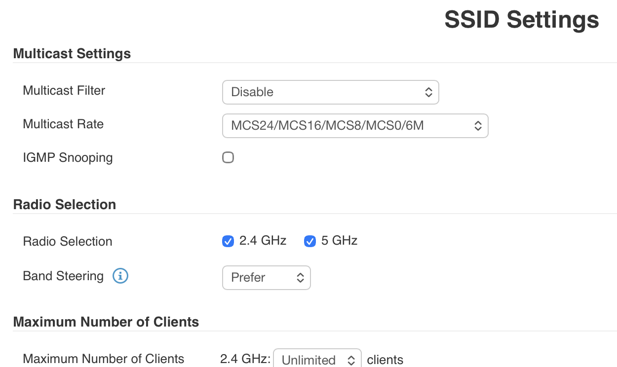

Is there an estimate of when the 6GHz radio will be supported in Incontrol2? I am testing one of these and there is no option in the group-wide SSID screen to enable 6GHz on an SSID. If I enable it locally on the AP it of course gets overwritten by InControl. The other issue is that you can only select 20 and/or 40MHz channel width for the 6GHz radio in the group radio config page.
Hi Charlie,
we plan to have Wi-Fi 6GHz support before mid of March in IC2 if all goes as smooth.
G.
We just got PoE AT mode working on the AP One Enterprise with firmware 3.9.8. Still in BETA, but worth checking it out when you get a chance.
