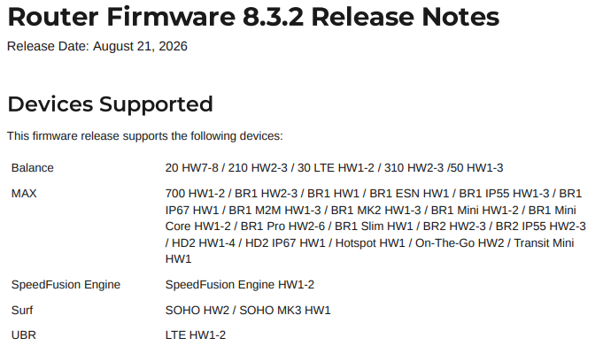

You can download version 8.3.2 for your device.
Surf SOHO MK3 HW1
https://download.peplink.com/firmware/br1ac/fw-max_br1mk2_hotspot_sohomk3-8.3.2-build5151.bin

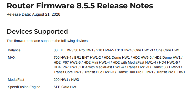

What happened to the recently aannounced 8.5.5 and the old 8.5.4–I don’t seem them in any download list for surf soho?
Surf SoHo MK3 it is too old to receive 8.5.5.
Also… You can check devices compatible with 8.5.5 at
The following devices receive update to 8.3.2
The following devices receive update to 8.5.5

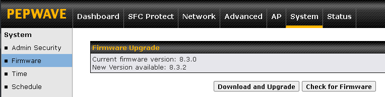

Abut the last Surf SOHO firmware → I could not find it on the Peplink website.
I found firmware for the Surf on the Go, but not Surf SOHO. I mention because I don’t trust a process I can’t see, so I like to check the website for firmware.
