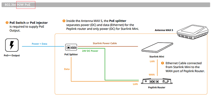

What is your solution to power a Starlink Mini and a BR1 Mini inside a Antenna Max S via PoE?
Just tried a PoE++ injector / Splitter setup but that is sadly not working. Don‘t know if it is just because of a bad injector / splitter or because PoE++ isn‘t enough power.
Kind regards from germany
Hi Christian.
You need a 802.3bt 90W source so you can have enough watts to power in both Peplink router and Starlink Mini antenna.
Thanks, I know. I had a PoE++ Injector and Splitter with 90W.
I just switched the injector and it’s finally working.
I’m now using an Intelligent INT 561495 Injector and a TRENDnet TI-SG104 splitter. The good thing with this splitter is that it has a terminal block with 2 outlets and a configurable output voltage.
